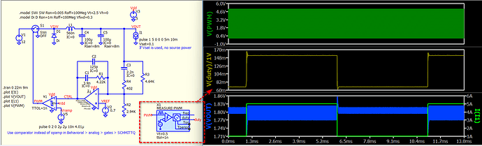

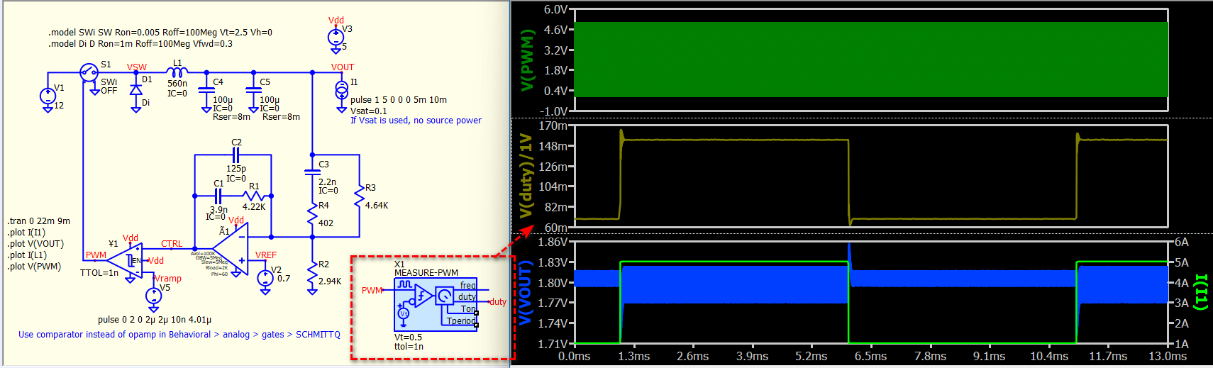

To simplify in reading duty cycles, you can put this custom symbol to give you cycle-by-cycle duty ratio, result delay by 1 switching cycles.
How to measure duty - QSPICE - Qorvo Tech Forum
it will look similar to this
