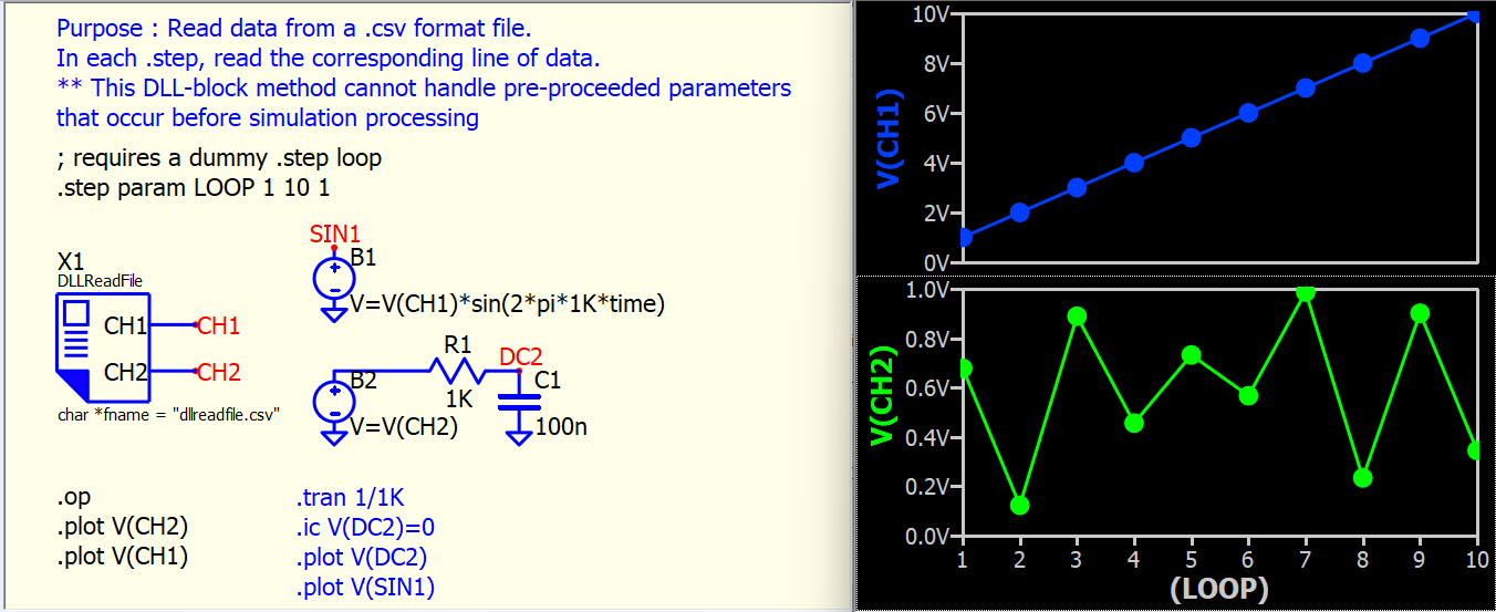

If you are allowed to feed a variable to a B-source, you have the option to load parameters by using a custom DLL-block to read an external file and feed the value into the simulation. Results would look like this.
