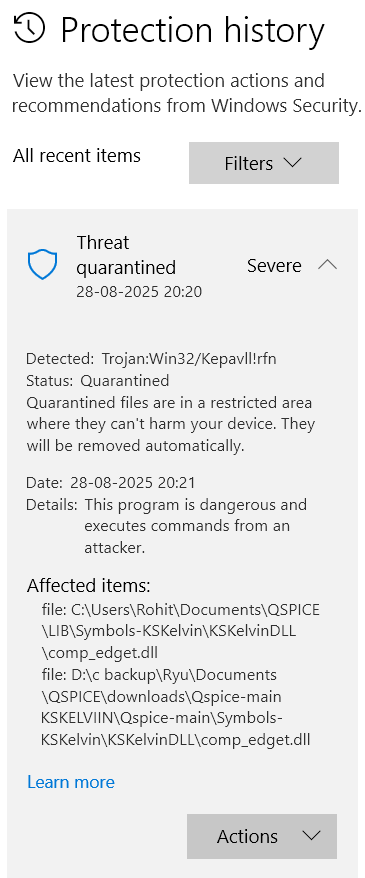

I a business laptop, the antivirus detects the .dll file as malware because of this the simulation not possible. The organization is not allowing to change the antivirus settings. What can be the solution for this ?

I have installed libraries from kskelvin’s github. Today Windows defender flagged .dll as virus.
This is the .cpp file, I have no idea why it get a threat triggered after compile to a DLL. It happens in my computer too. Well… this code is written a year ago and I will try update this code with latest Qspice C++ template.
comp_edget-threatQuarantined.cpp (3.2 KB)
I have rearranged the code into the latest C++ template, and so far, it seems okay. This is the new version that I will update on Github. I plan to remove the .dll file from Github, as Qspice can now prompt a window to ask for compilation. This way, people can review the code and won’t get easily confused about what is happening. Thank you for letting me know.
