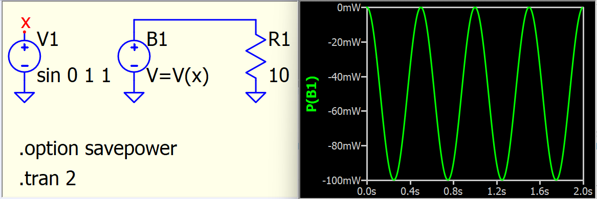

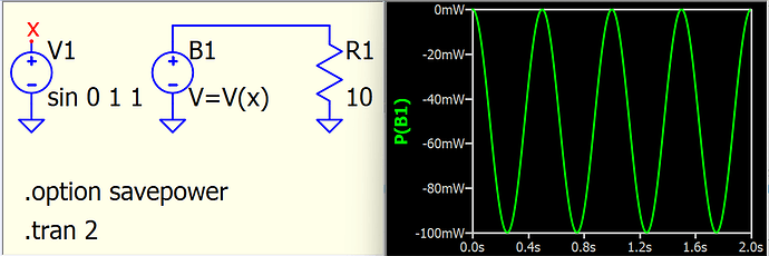

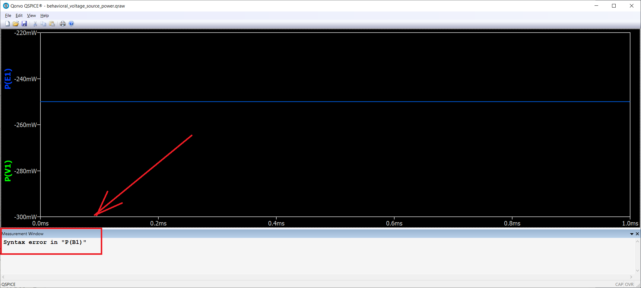

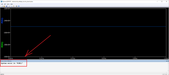

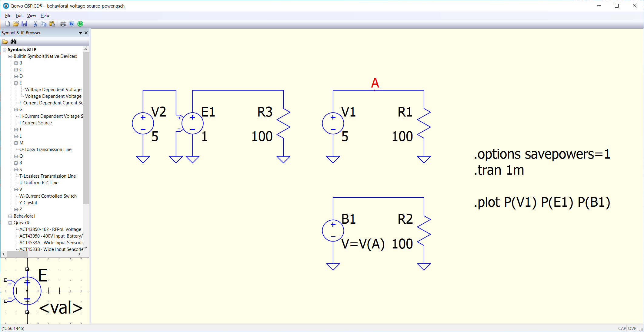

I have discovered that power measurement (CTRL + click) does not work for Behavioral Voltage Source. At the same time, for instance, there is no such problem with a regular Voltage Source and Voltage Dependent Voltage Source; power measurement works fine for them. I am attaching two screenshots illustrating the problem.
I would be grateful if power measurement could also be added for BV sources, if possible.
