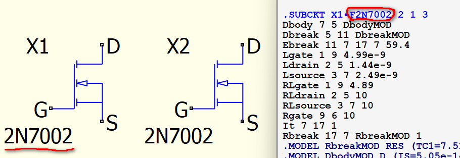

2N7002 3rd party model not functioning?
The subcircuit you downloaded has the model named F2N7002. The first attribute of a symbol must match the .subckt name. The solution is to put a ‘F’ in front of 2N7002.
You can consider this workflow instead, everything is copy and paste only.
