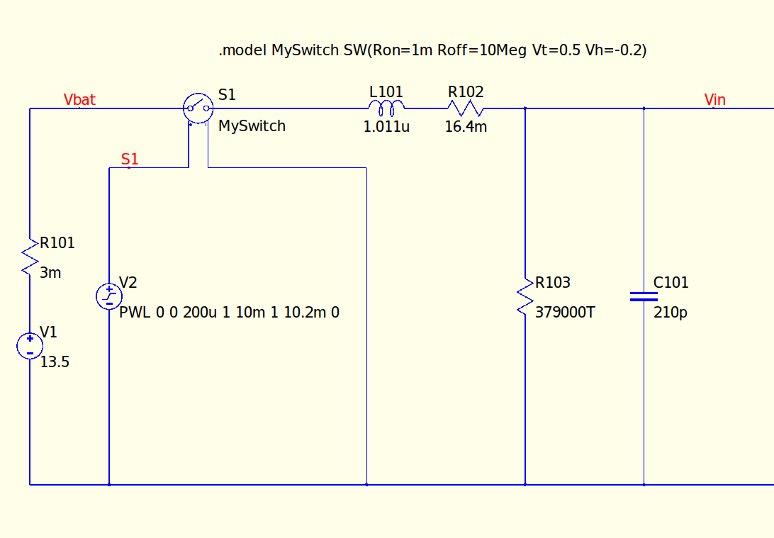

I try to use a voltage-controlled switch (S1), but it doesn’t switch. The switch is supposed to simulate a hot-plug event in the supply wire.
A piecewise-linear voltage supply V2 shall control the switch S1. V2 goes from 0V to 1V after 200µs, stays at 1V for 10ms and goes back to 0V. The threshold voltage of S1 is set to 0.5V with a hysteresis of 0.2V. The hysteresis is negative to simulate a smooth transition from closed to open.
However, S1 is “dead”. It remains open the entire simulation time.
I already tried different things, a zero or positive hysteresis. I also tried to directly assign the model parameters to S1 instead of the indirection via MySwitch. Nothing helps.
I assume the reason is probably something completely trivial and I simply don’t see the forest for the trees. What might I be missing?

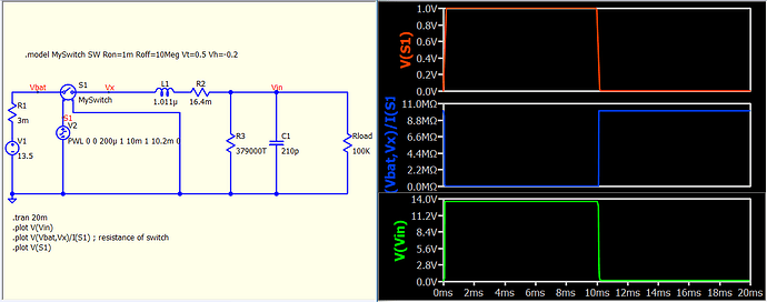

Initially, I had designed the schematics in KiCAD and used the integrated Ngspice for simulation. However, as some of the simulation results seemed odd I wanted to re-run the simulations in a different SPICE derivative for comparison. I did not just import the netlist from Ngspice into Qspice, but I recreated the entire circuit in Qspice from scratch. When I shorten the switch, the remaining circuit seems to work as expected. But that switch drives me crazy.

Anyway, I solved my issue. :partying_face: However, I cannot say what I did differently this time. I started with complete empty schematics file again, re-created everything and now it just works. That’s of course a completely unsatisfactory solution. Lucky me that the entire circuit wasn’t that large.
