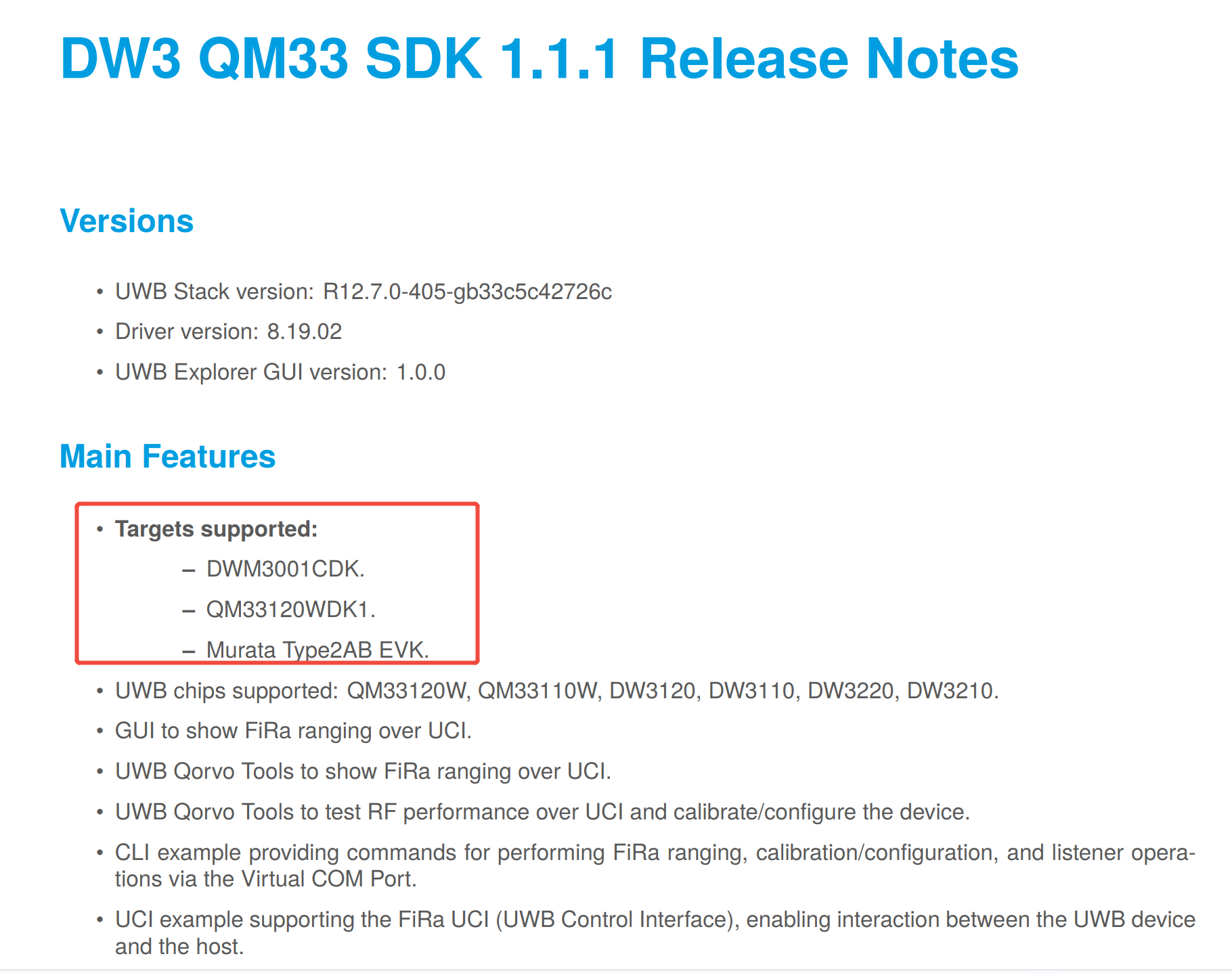

When can DW3 QM33 SDK v1.1.1 support nRF52840-DK?
It can be seen that DW3 QM33 SDK v1.1.1 supported targets don’t include nRF52840-DK, so when will nRF52840-DK be supported?

Hi @paopaohepan ,
QM33120WDK1 has nRF52840, so you can use the FW in QM33120WDK1 folder.

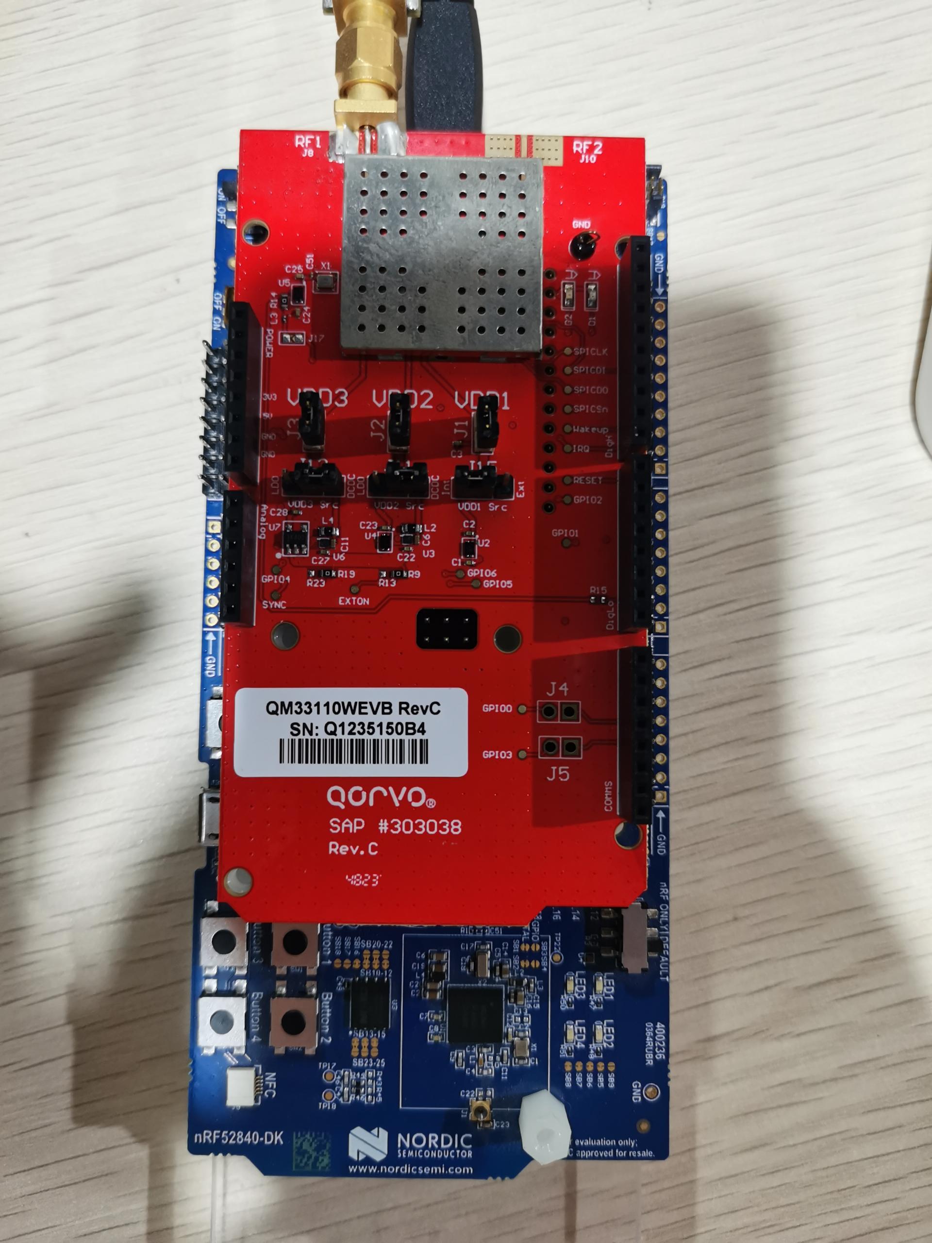

Thanks. I change the shield of my nRF52840-DK from DWM3000 (the white board in the picture above) to QM33110WEVB (the red board), as shown in the picture below, and then it works. BLE can be connected, distances can be measured. And then I test QM33120WEVB and also works.

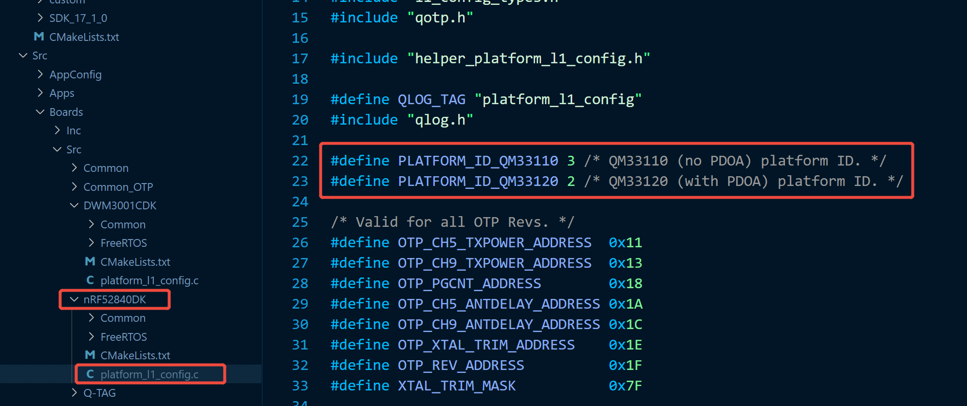

So it seems that SDK v1.1.1’s support for nRF52840-DK is limited to the QM series (QM33110 and QM33120) and does not include the DW series (DW3110 and DW3120).
The following code snippet seems to validate my guess.

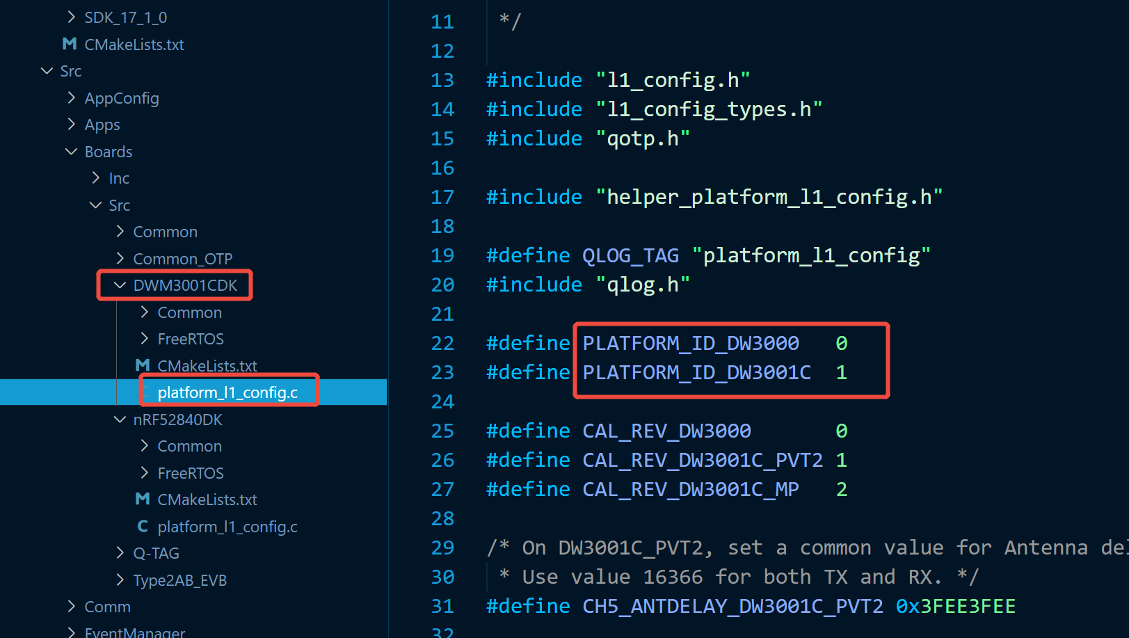

In the src/Boards/src of the SDK, it can be seen from platform_11_config. c in the DWM3001CDK directory that PLATFORM_ID_DW3000 and PLATFORM_ID_DW3000C are defined, without including QM series tranceiver. This is reasonable because the transceiver of DWM3001CDK is dw3110.
However, only two QM series transceivers are defined in platform_11_config. c in the nRF52840-DK directory, and no DW series transceivers are defined. So this should explain why it starts working after I change the shield of the nRF52840-DK from DWM3000 (the white board) to QM3110WEB (the red board).
Please confirm whether my guess is correct. If so, does Qorvo have any plans to add support for the DW series transceivers for nRF52840-DK in the future versions of the sdk?
In addition, I would also like to further understand the differences between the DW series and the QM series transceivers, that is, what are the specific differences between DW3110 and QM33110, as well as between DW3120 and QM31120?
