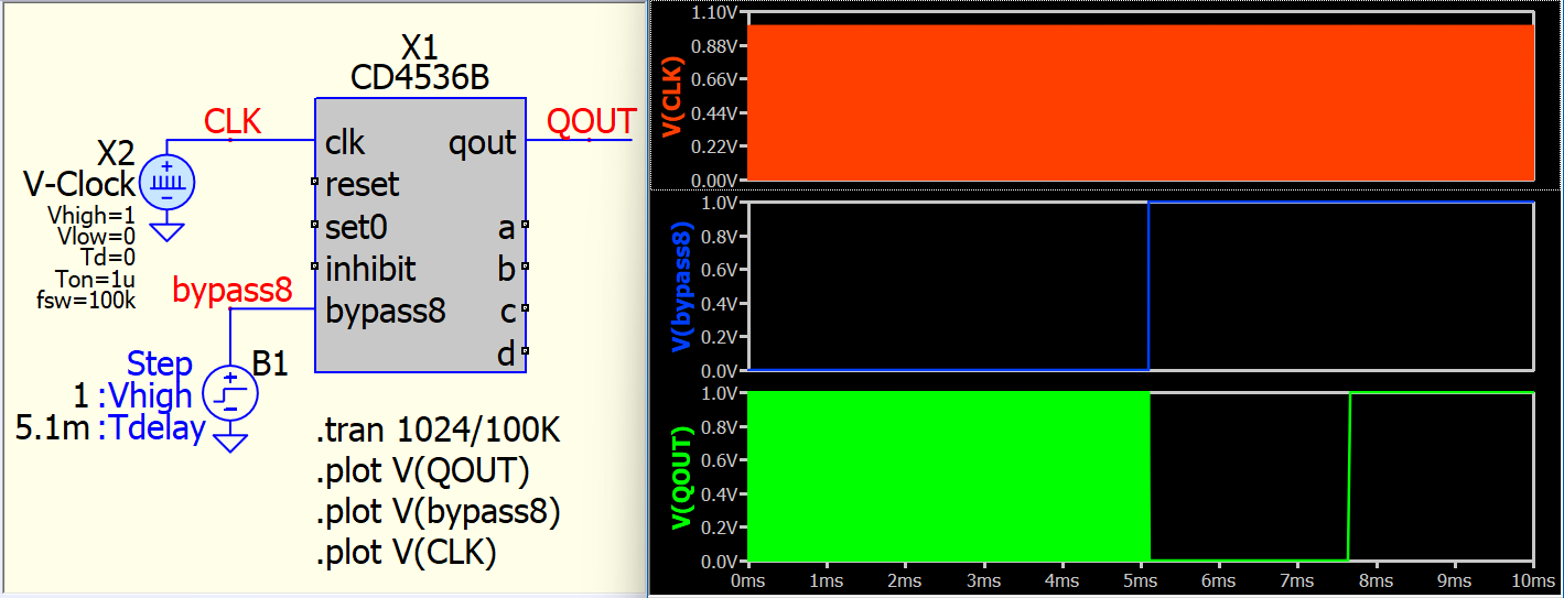

Test results of your code.
CD4536B.qsch (4.0 KB)
cd4536b.v (981 Bytes)
