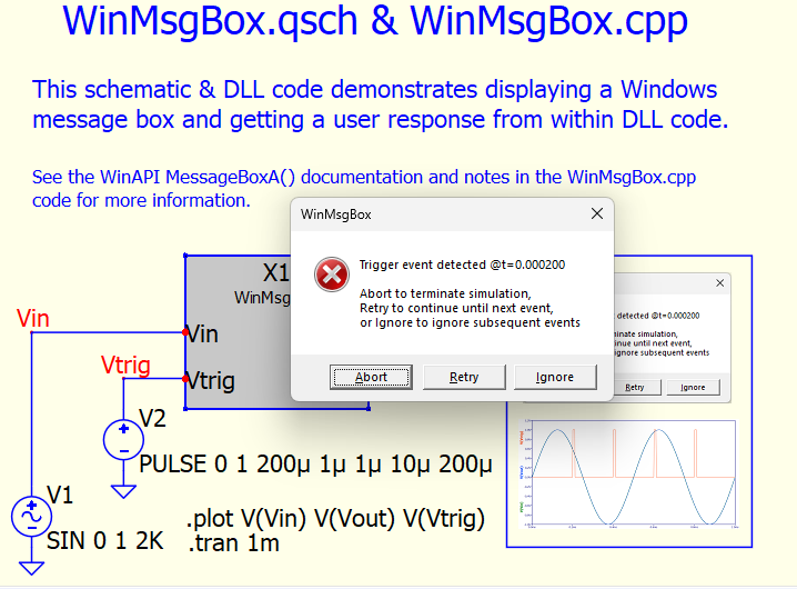

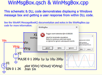

GUI_HWND is a Windows handle to the QSpice schematic window if the simulation was launched from the GUI. If the simulation was launched from a command line (i.e., with QSpice64.exe or QSpice80.exe), this is a null value.
We can use GUI_HWND to display a Windows message box and get a user response from within a DLL. For an example, see the WinMsgBox schematic and code in the Miscellany section of my GitHub QSpice repository.
