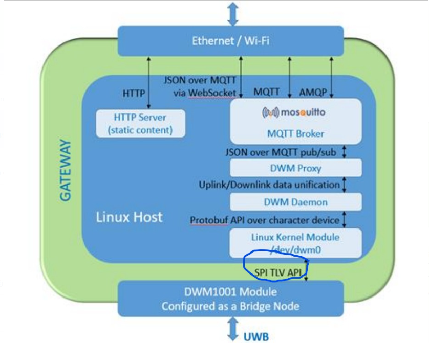

Configuring anchors and tags using ESP32 from Bridge node with SPI TLV API as seen in the picture,
situation,
I want to send location data. Again with ESP32 I want to send some data from bridge node to tags. (such as buzzer, motor, relay enable/disable). Is it possible
Hi @ramazan
there is no port of gateway for ESP like devices. There is only RPi gateway for PANS.
With the regards of TLV SPI - this is documented in the API document DWM1001-API-Guide.pdf - 5.4 Backhaul API functions so you can implement your own code to work with bridge node. However this task is very complex and it need precise timings. There will be vey limited support from our side.
