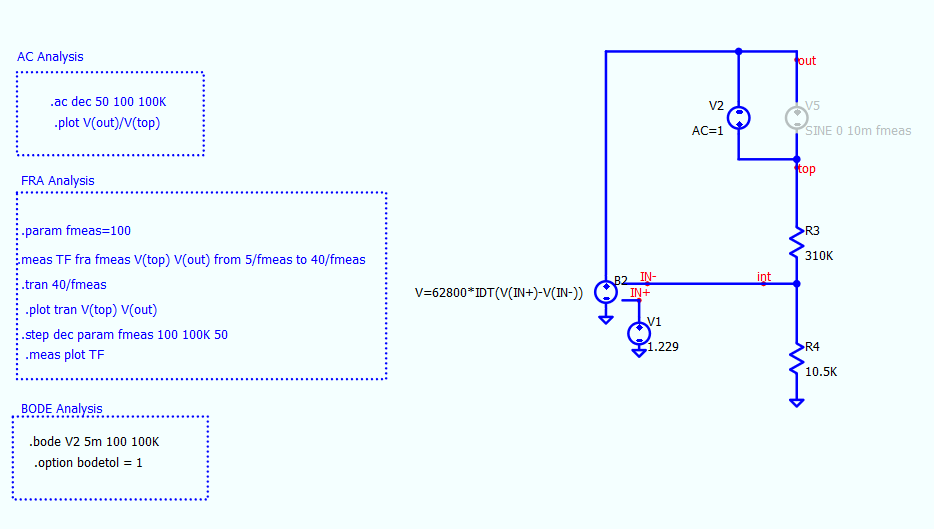

I’m clearly missing something while trying to use FRA analysis. I made an extremely simple test feedback circuit to try to measure open-loop gain:

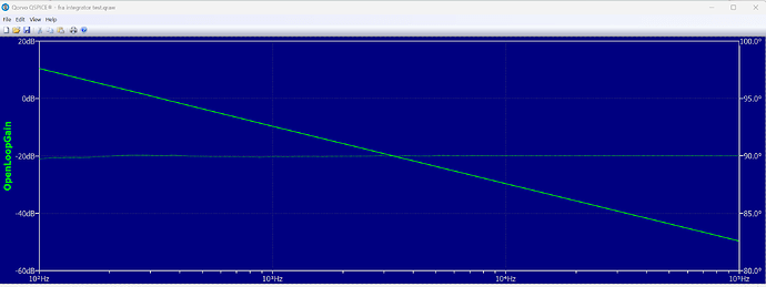

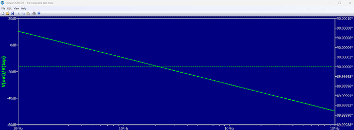

When I use AC analysis I get exactly what I would expect, an integrator with ~10 dB of gain at 100 Hz and 90 degrees phase shift:

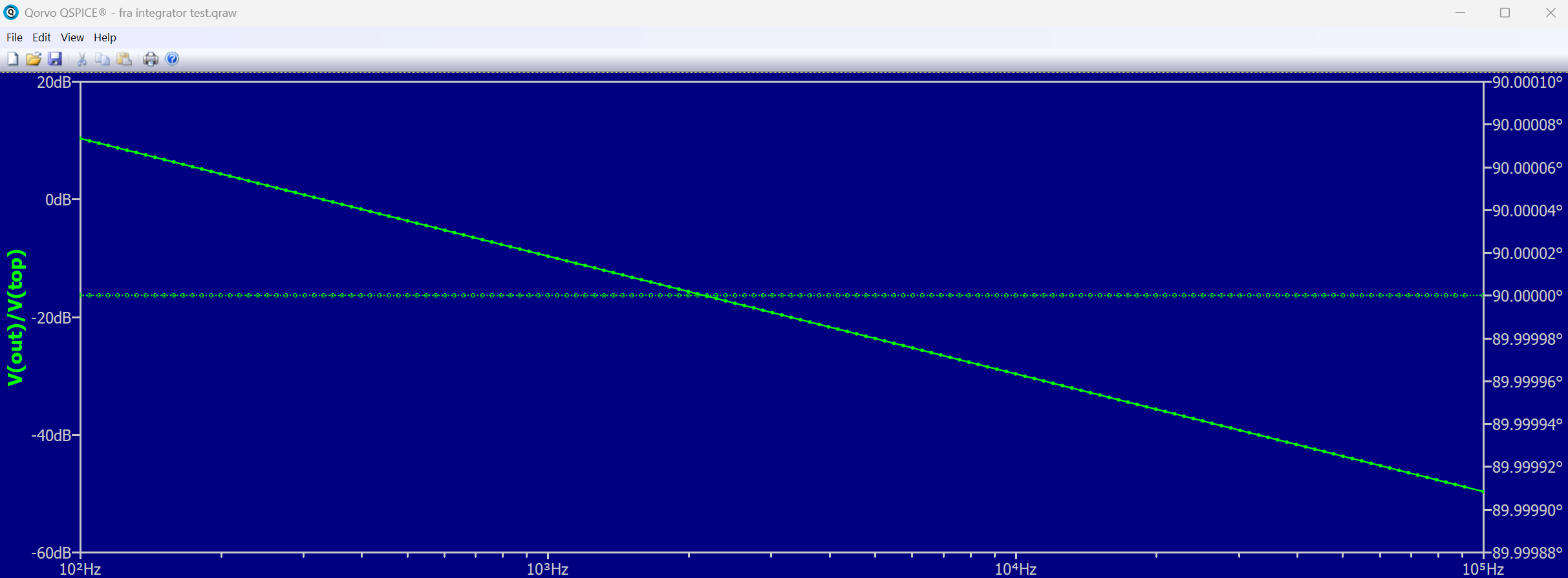

Bode analysis is the same:

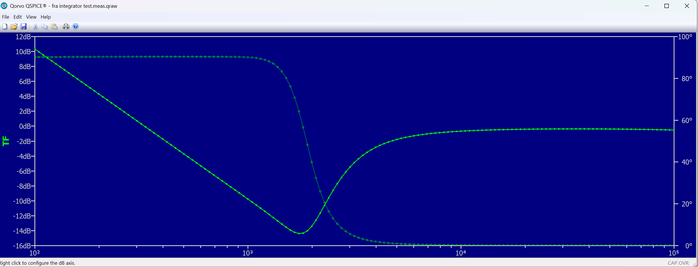

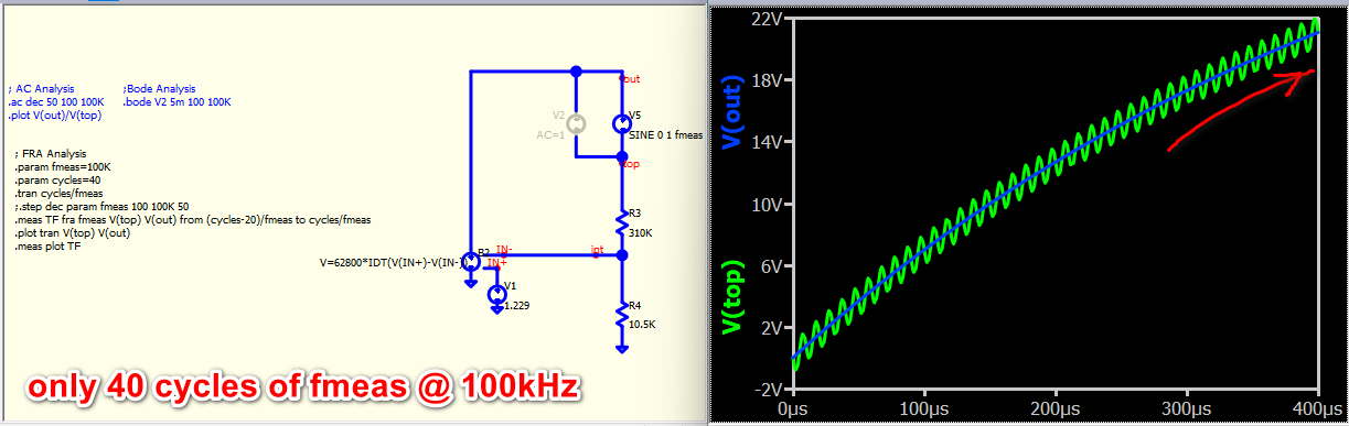

But when I use stepped FRA analysis I get the following:
Which seems to be accurate to a certain frequency, then it diverges from the correct response.

Check time domain simulation data, at fmeas=100k, .tran 40/fmeas is not enough to reach steady state. Here change cycles to 400.
fra integrator test (KSK).qsch (5.2 KB)
Of course, thanks again Kelvin!
