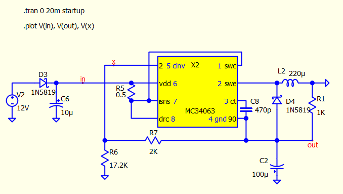

Hi,
I am trying to simulate a -12V MC34063 inverter circuit in QSPICE using a MC34063 model I found online and values calculated via an online MC34063 calculator.
However, I get a fatal error, Fatal error: Timestep too small(1.25e-19) at t=0
Is there an obvious error that I am not seeing?
QSPICE Schematic File:
“New Users cannot upload files”
Online MC34063 Calculator Values:
Vin 12 V
Vout -12 V
Iout 140 mA
Vripple 150 mV(pp)
Fmin 45 kHz
Ct = 471 pF
Ipk = 596 mA
Rsc = 0.504 Ohm
Lmin = 217 µH
Co = 99 µF
R1 = 1.5k
R2 = 13k (12.08V)

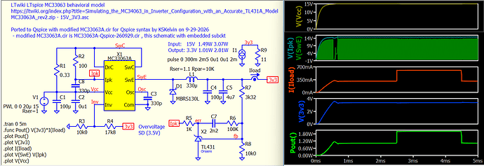

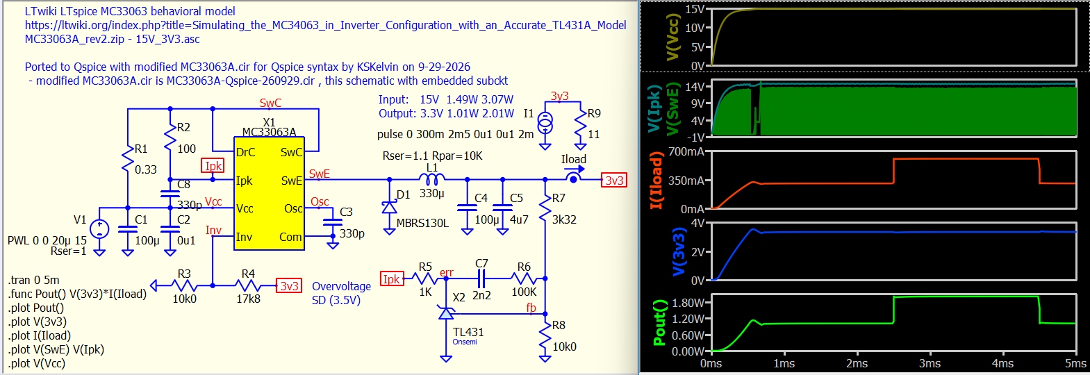

The subckt you quote is from Onsemi website : MC34063A , but its contain unknown SPICE syntax.
LTwiki with a functional MC33063A simulation package (Simulating the MC34063 in Inverter Configuration with an Accurate TL431A Model - LTwiki-Wiki for LTspice ), but it contains LTspice A-device, which requires to modify and make it work in Qspice.
Two Qspice examples are upload, search these filenames in the Github link :
Onsemi.MC33063A.15V_3V3.qsch | Onsemi.MC33063A.Floating GND Test.qsch
QSpice-Circuits/Qspice-examples: Qspice circuit examples
Here is a screenshot for Onsemi.MC33063A.15V_3V3.qsch
