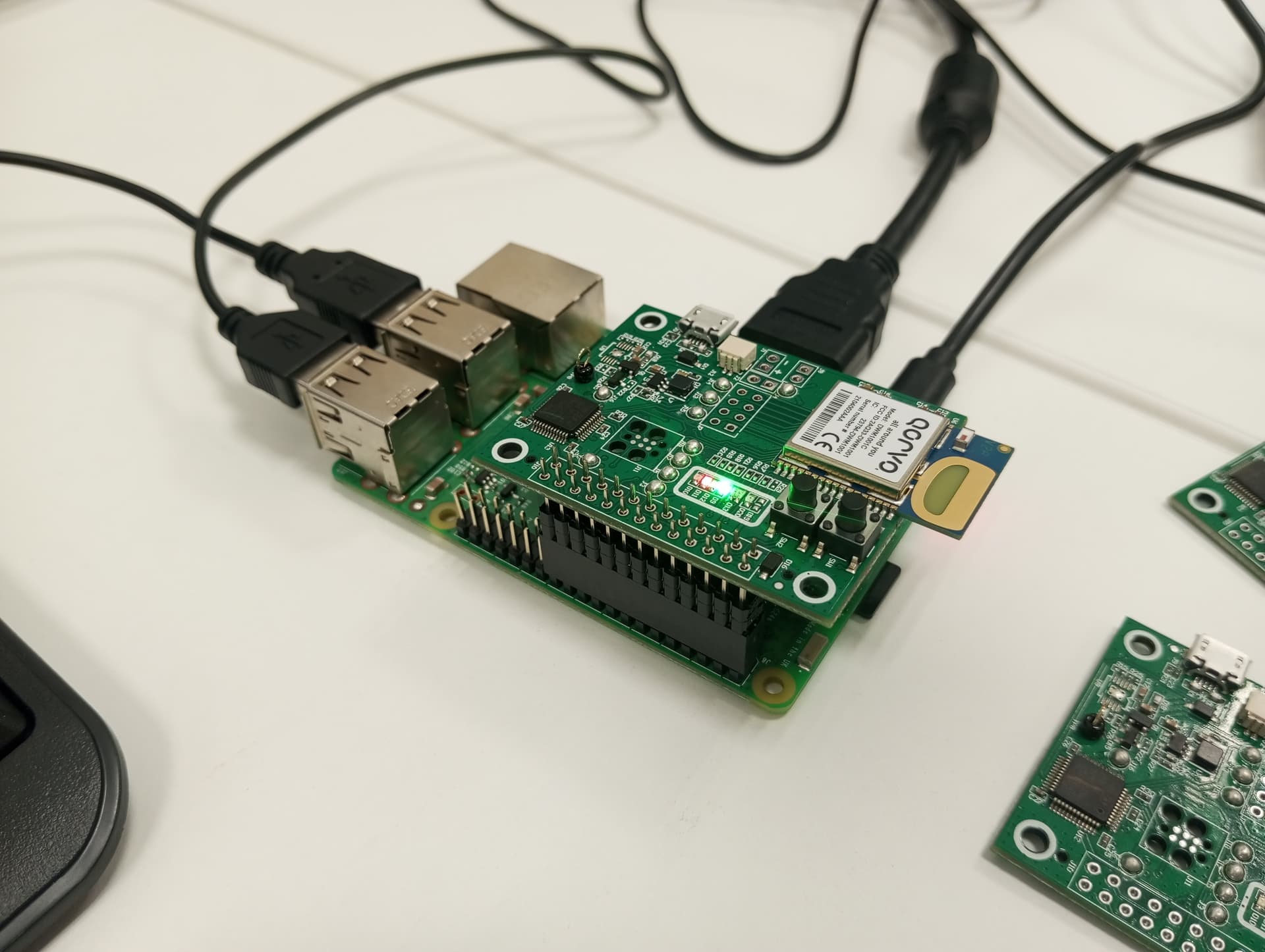

I was trying to connect the modules to my raspberry pi 3B hoping to configure it with the uart shell. The raspberry, which is the 3B suggested model, has been flashed with the OS provided by Qorvo, specially because after configuring the anchors i would like to set one as tag and gateway to send all the data recording the CIRs.
Unfortunately, not matter what I’ve done, every time I run the minicom I cannot type anything. I do not know what to do. I attached my setup as an image: the module is on the pi 3B pins with the extended head.
