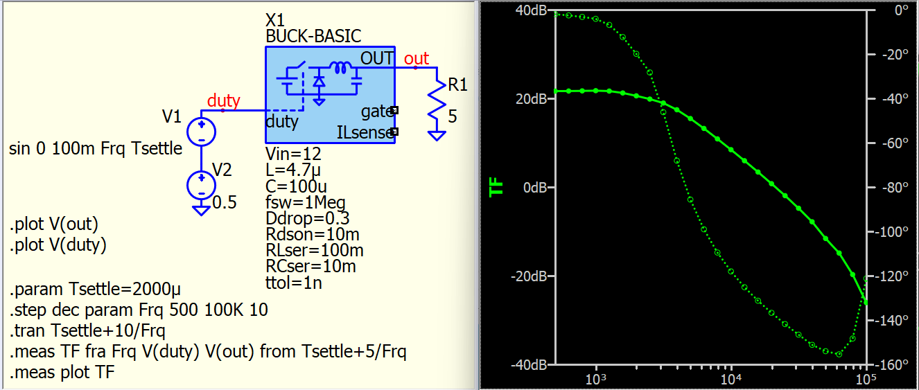

I am not sure what went wrong in your case.
Here is an example set up with conditions similar to what you did.
.meas - fra - 04 Parameterized Tstart.qsch (5.1 KB)
