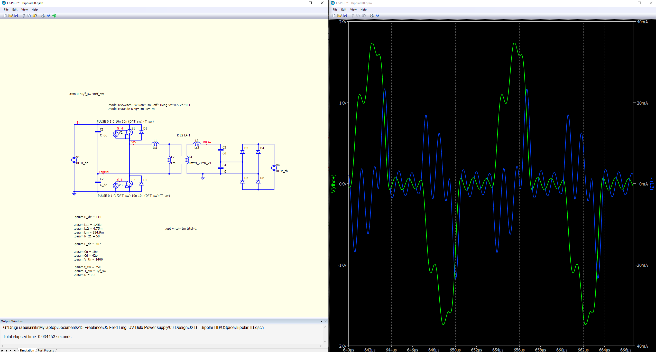

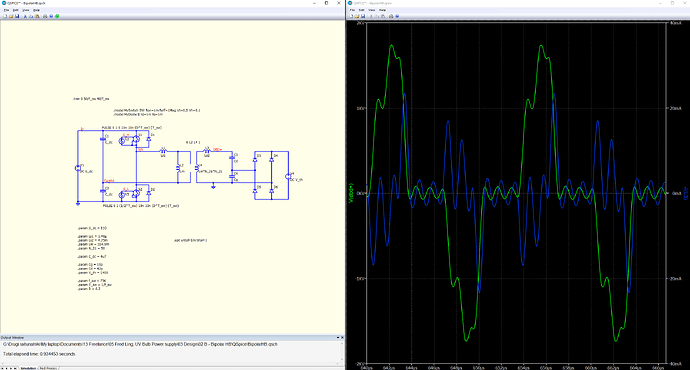

I am simulating a design using a transformer. I have tried the mutual coupling parameter K and also the transformer model X.
When testing them on a simple sinewave input they both behave the same way, but when I instert them into my circuit they significantly alter the behaviour of signals.
Here is a screenshot with the K parameter:
And here is a screenshot with the X model:
(in the following post since I cant post two screenshots…)
Any suggestions on what is causing the difference?

And here is a screenshot with the K parameter:
Why you not defined transformer parameters as described in Help file?
Well they are, aren’t they?
The only mandatory parameter is TURNS which i have specified. All other are additional parameters. Did i overlook something?
