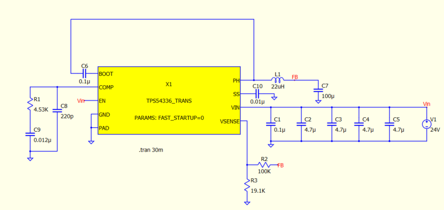

I am getting error “Fatal error: Error: no such subcircuit: driver_u8_s4” when I am run the simulation for the tps54336 transient version of the model in QSPICE.
I am not getting any errors when I use LTspice for this model. I imported the model into LTspice by opening the file in ltspice, right clicking on the sub circuit “TPS54336_TRANS” and hitting “create symbol”.
I’m not sure if I’m doing something wrong or if there is a bug
Maybe you didn’t check the box to include the whole file. You can e-mail the model to me.
Wow that worked. Thanks, that was such an easy fix. I feel foolish now :sweat_smile:
