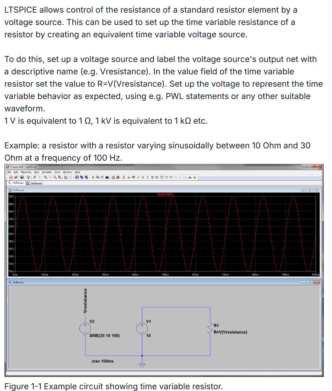

Is there a similar method in Qspice to implement variable resistors?

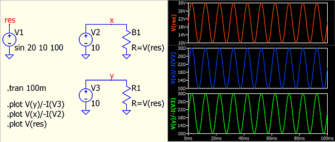

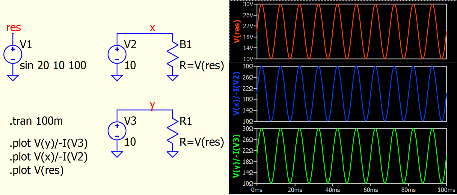

I think the exact method can work… anyway,
- Method 1 : Press B key 3 times, for Arbitrary Behavioral Resistor symbol.
- Method 2 : R key to place a resistor, and in
<value>, type R=…
RES.qsch (3.9 KB)
