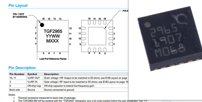

TGF2965-SM marking detail
The data sheet marking:TGF2965 Why is it that the actual only 2965. Are there any official documents?

It looks like the datasheet had a slightly old branding diagram, sorry about that. The branding should be as per the below image. The marking corresponds to:
2965 : PART NUMBER
YY : PART ASSY YEAR
WW : PART ASSY WEEK
M: VENDOR CODE
XXX : LOT NUMBER
The branding has changed again and moving forward a 2DID code will be used, alongside part number 2965 and a trace code. The use of a 2DID code gives better tracability. The datasheet should be updated soon to reflect this change.
