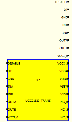

Hi All, when am importing a sub circuit of UCC21520, am not getting that properly in Qspice. The snip attached below
the left side pins are replicated as in snip.
Could anyone can suggest, how to figure out this?

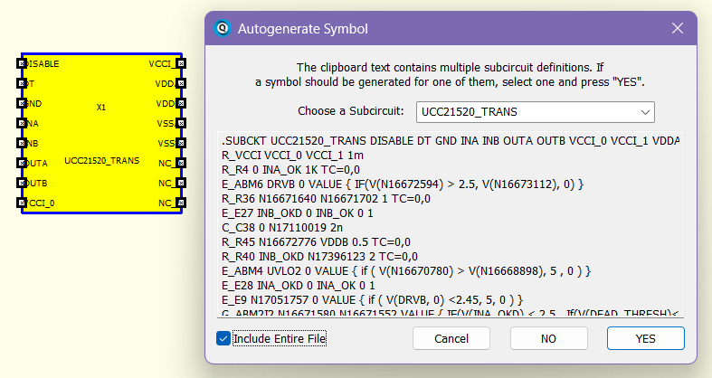

Cannot replicate your issue. Are you using latest Qspice, and unencrypted Pspice model from TI?
https://www.ti.com/lit/zip/slum543
Hi Kevin, Now I updated the Qspice with latest version. The issue has been resolved.
Thanks for your valuable support
