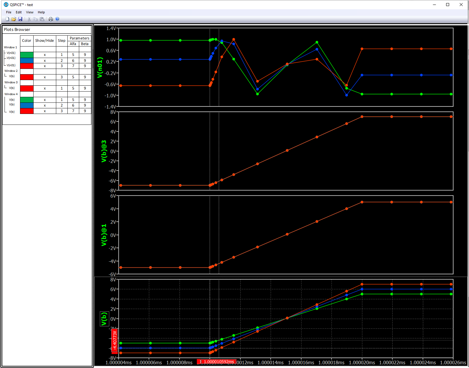

About the “step” information in the status bar: yes, easy to see the step number, but actually you don’t know the parameter values. Especially in multiple nested stepped simulations, you just see the progressive step number, but you don’t know what is referring to. It would be nice to have it showed in the status bar.
I have the same feedback. It would be even better if in further developments there will be sort of a “Results Browser” in which for each plot window the results:
-could be added/removed, shown/hidden, etc…
-had a paramete(s) attribute.
-recall the color they have in the window
Last but not least, it would be really cool if data belonging to the same step had the same color in all windows.
