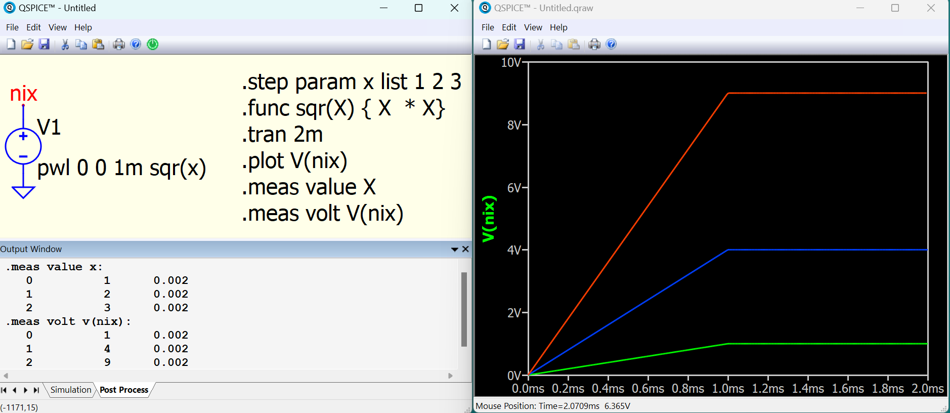

It’s easier to understand something like this in a concrete example. You can e-mail it to me at the e-mail address on the Help=>About box. Otherwise, as I understand your post, this would be a counter example:
