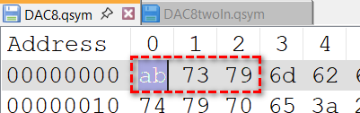

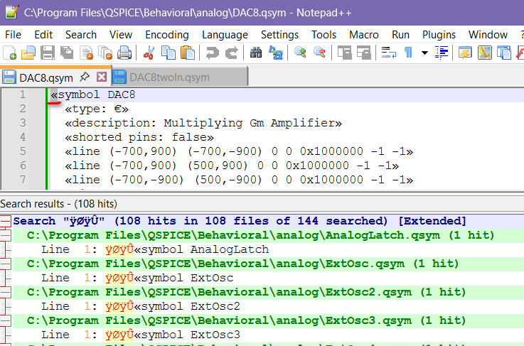

You can try any qsyms from the installed. Some have a start sequence, So far work with
I guess in early development, leading characters ÿØÿÛ may not be implemented and symbol created before that doesn’t contain these leading characters. For example, DAC8.qsym begin with «symbol without ÿØÿÛ, it HEX sequence is AB-73-79…
With and Without these leading character can work fine. All symbol created through Qspice Symbol Editor with leading characters ÿØÿÛ added.
