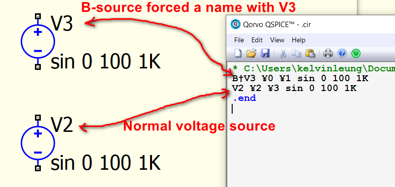

If your netlist device is called B†V1, this is a Behavorial source instead of Voltage source, and you forced to rename it from Bnnn to Vnnn.
My suggestion is that you delete that source, type “V” to place a Voltage source, and set to SINE 0 100 1K
Thank you, I see my error and have corrected it.
I also needed to tick “Port” for IN
Solved
