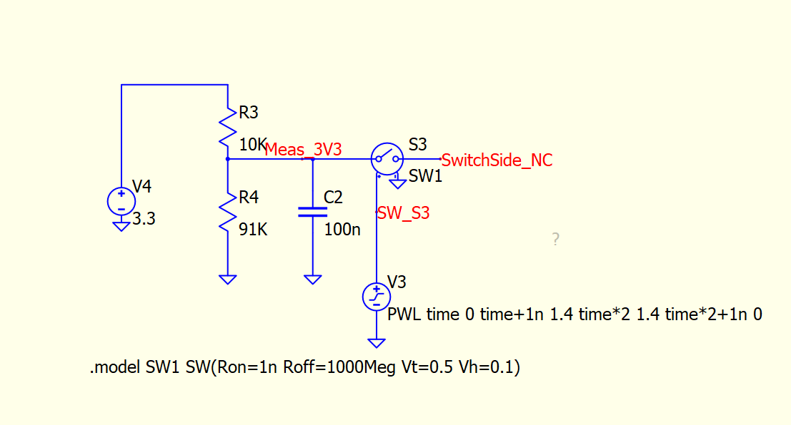

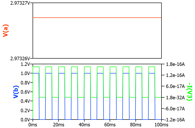

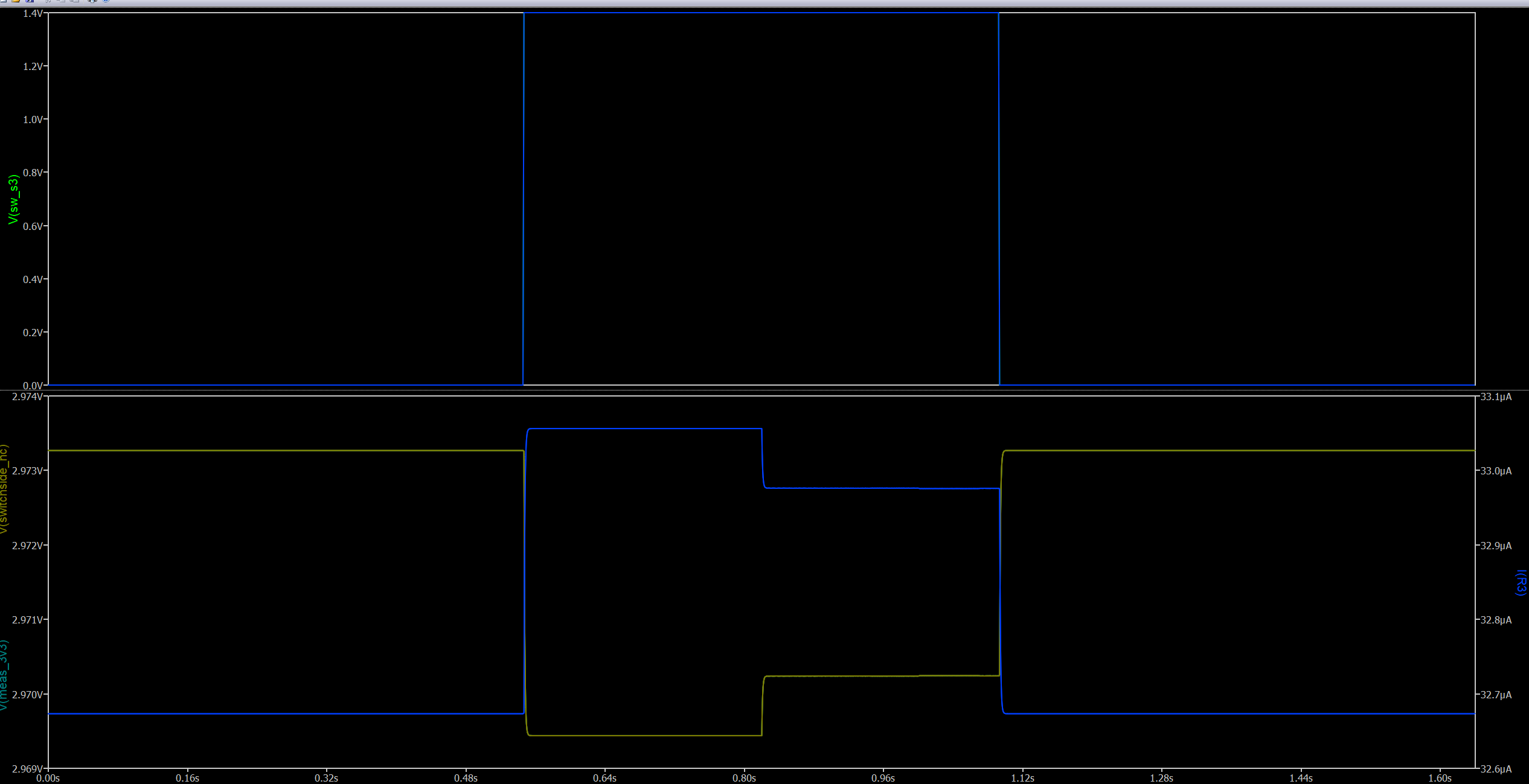

Hi,

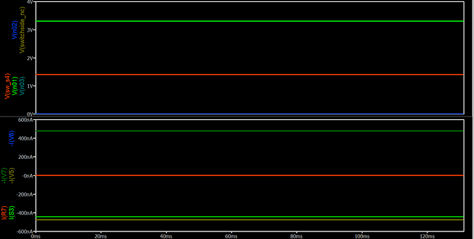

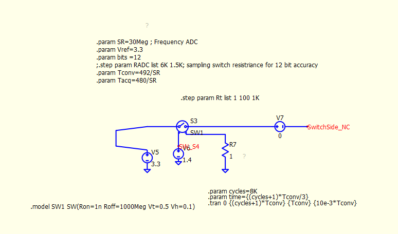

I can’t quite understand how SW1 can load the circuit when “SwitchSide_NC” is floating.
it’s like the SW has parasitics that isn’t constant to ground.
Could someone explain this to me? and if so how can I get rid of the parasitic loading?
Some more info:
Seem like the SW1 magically draws power from V5 without the current going anywhere where you can probe its where about.
