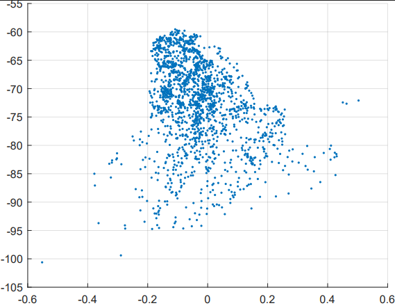

To validate this hypothesis, an experiment was conducted in which two devices—the anchor and tag—were positioned two meters above the ground and with the same initial orientation. I placed them at a height to avoid multipath.
Data collection began, and the tag was continuously rotated, attempting to cover as many angles as possible and, consequently, attenuation from the radiation pattern. The distance and rx power were measured at the tag, and knowing the actual distance between the devices—approximately six feet—the measurement error in relation to the incoming power was calculated.
The X axis is the error in meters and the Y axis is de power attenuation in dBm.
Well, with this result, the only thing that came to my mind was that I have to change the antenna. Does anyone know of a way to get around this problem and make the UWB measurement more stable to angle variations?
