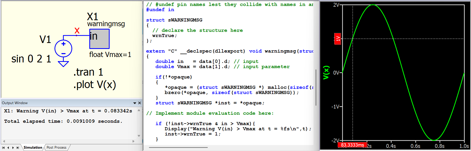

It seems only DLL-Block (Ø-Device) can return message in output window.
Here is an example for your reference.
warningmsg.qsch (1.3 KB)
warningmsg.cpp (3.4 KB)

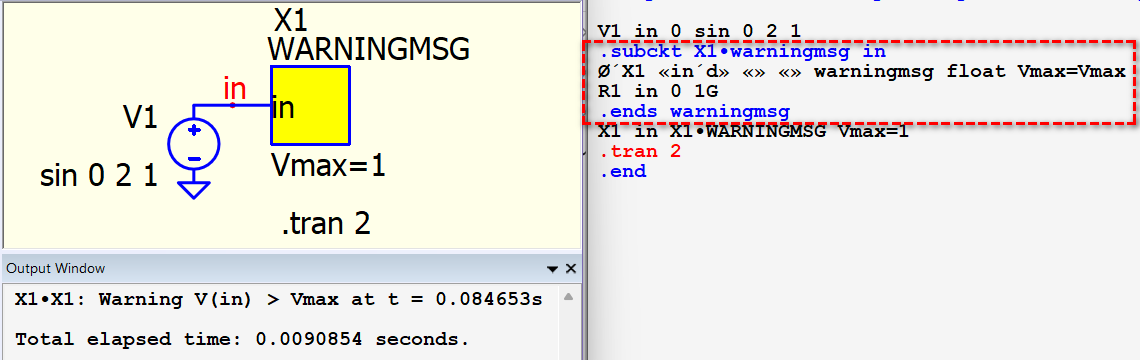

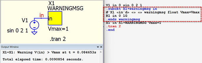

Actually, the Ø-Device (DLL block) can be a part of a .subckt in Qspice. Here is an example where the above DLL block is built into a subckt. The only additional item you need is to share the .dll file along with the subckt symbol you created.

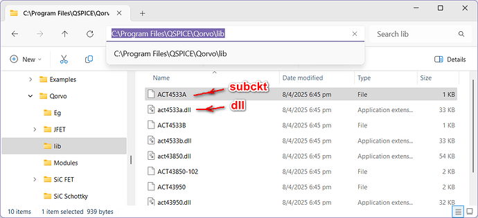

In Qspice, there is a Qorvo library created in this manner.
