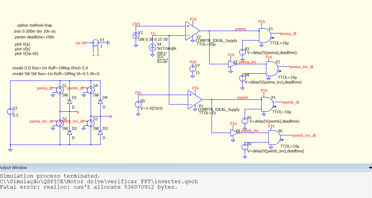

Hello,
I’m receiving this error message: Fatal error: realloc: can’t allocate 536870912 bytes.
Is there any way around the error without sacrificing the simulation’s temporal resolution? My simulation time is 100ms and maximum time step is 10ns.

Well, before raising an issue with Mike, maybe you could post the schematic and we’ll see if others can reproduce the problem. (If it’s a memory leak truly exhausting memory, we should be able to reproduce.)
can you upload this schematic and we can see anything can help?
Kelvin,
inverter.qsch (29.5 KB)
Possibly delay consumed all memory. Change to release delay history format.
Change all delay function formula from delay(V(pwmb_inv),deadtime) to delay(V(pwmb_inv),deadtime,deadtime*2).
i.e. from delay(x,y) to delay(x,y,z)
It works. Thank you Kevin.
