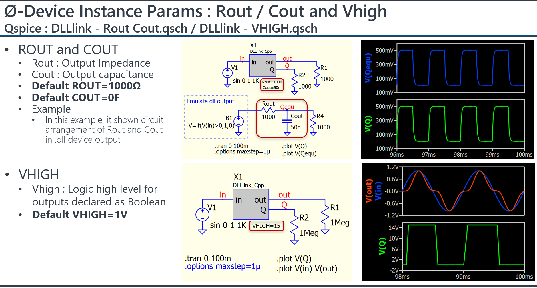

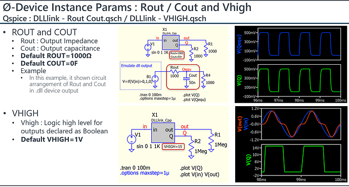

Rout, Cout, and Vhigh are instance parameters which are set using Add Attribute by right-clicking the symbol. They are not adjusted through C code. All pins follow same setting.

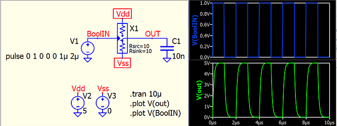

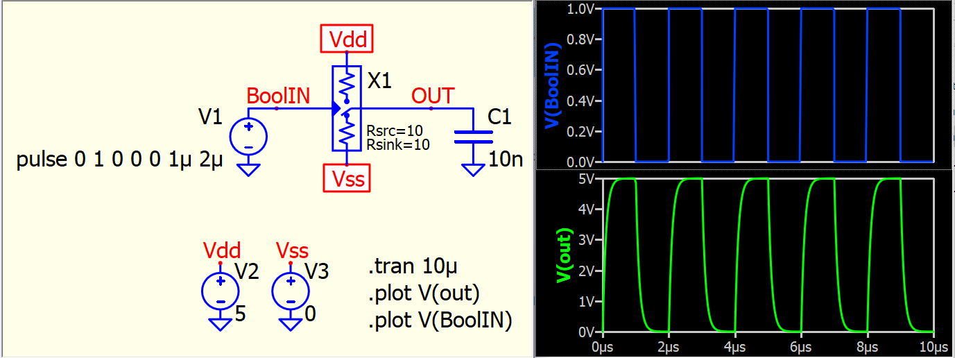

Here is a symbol that can set Rsource and Rsink, if your output signal from DLL is Boolean. For your reference.
Output-SrcSink.qsym (1.4 KB)
example.Output-SrcSink.qsch (4.8 KB)
THX, ill play with the attached files
