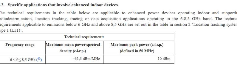

@EddieKu, I would also recommend taking a look at our new QM35825
which has an integrated PA that can take advantage of this new regulation.
Please see section 4.2 here. This regulation is only applicable for indoor devices: Implementing decision - 2024/1467 - EN - EUR-Lex
