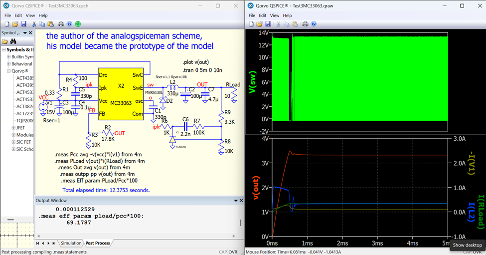

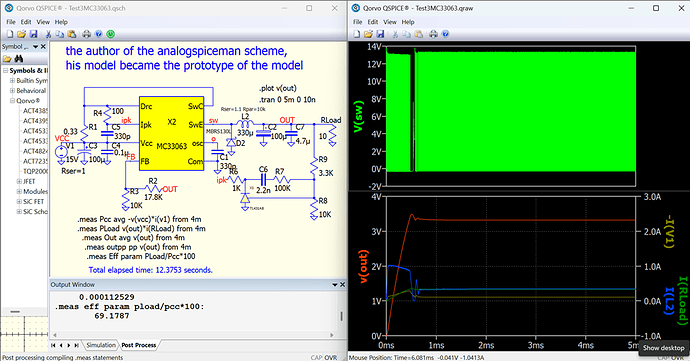

For this week’s QSPICE schematic capture, we have “Test3MC33063” by our friend Alexander Bordodynov. “Here is a non-standard application of the well-known MC33063 chip. At the same time, the improved parameters fully pay for the complexity of the scheme. The idea is from analogspiceman (our late friend Dave Edwards). I adapted his model for QSPICE®.” (Schematic Capture Post #051) Please send any submissions to tim.mccune@qorvo.com.
Test3MC33063.qsch (17.6 KB)

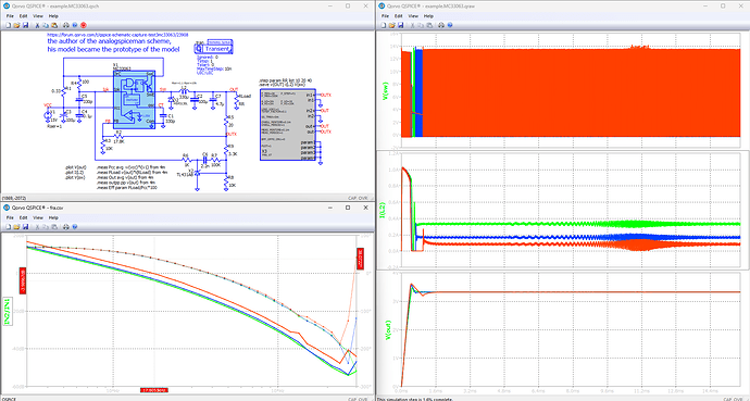

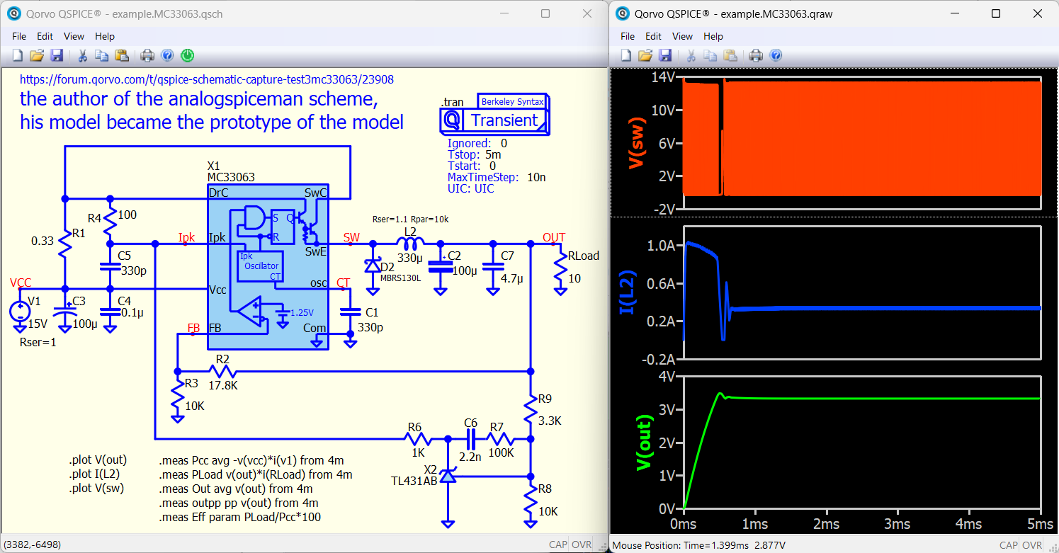

Let’s spice things up.
example.MC33063.qsch (24.7 KB)
MC33603.qsym (5.5 KB)
TL431AB.qsym (1.9 KB)

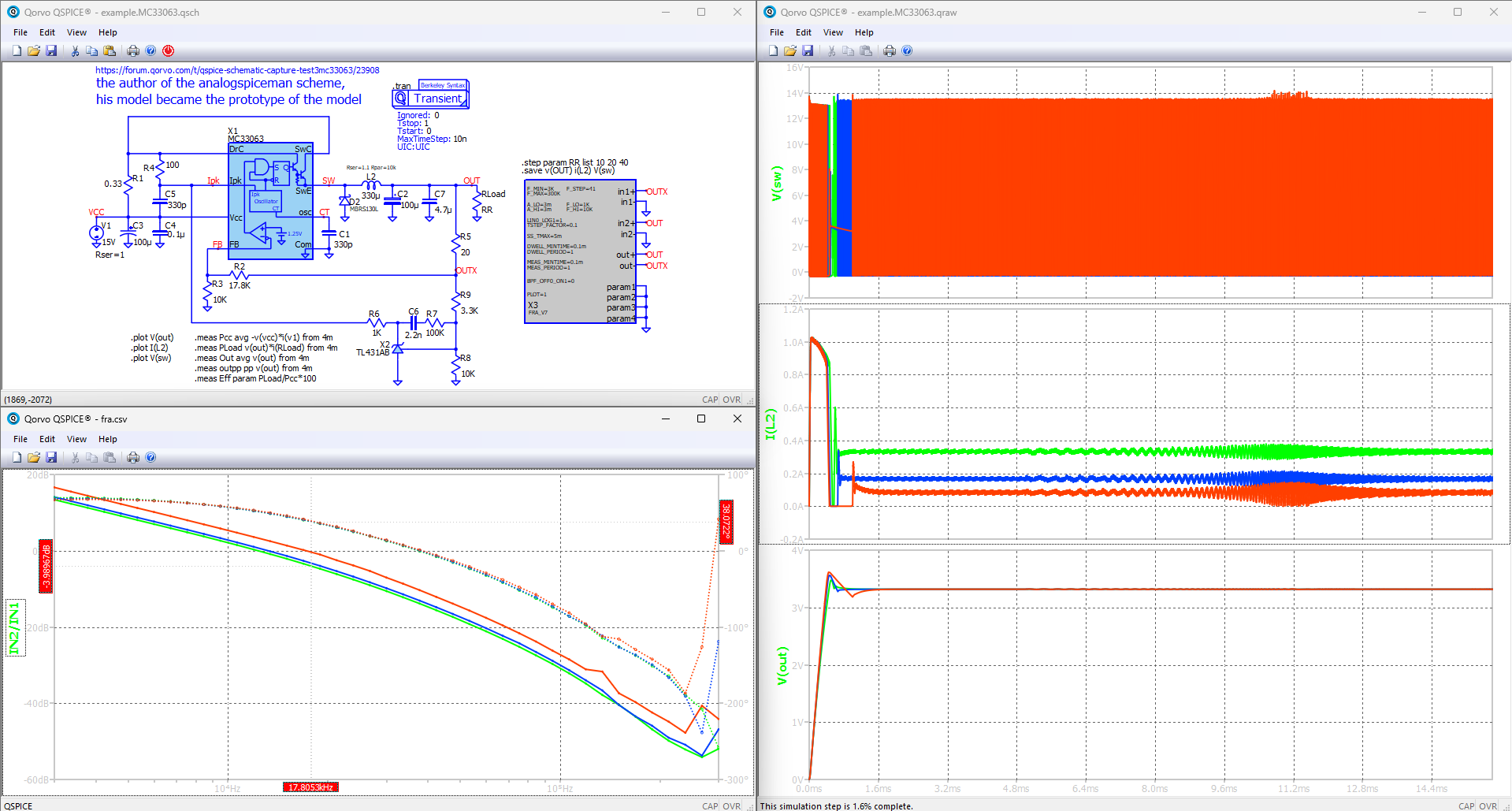

May I join the party?
example.MC33063.qsch (28.2 KB)
fra_v7.cpp (12.4 KB)
FRA_V7.qsch (8.1 KB)
