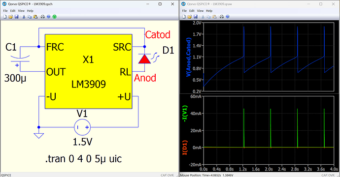

QSPICE Schematic Capture (Simple LED flashing light with low voltage power supply 1.5 V)
Here is this week’s schematic capture, by our friend and frequent circuit simulation contributor Alexander Bordodynov. This is an implementation of the LM3909, “Simple LED flashing light with low voltage power supply 1.5 V.” Please send any submissions to me at tim.mccune@qorvo.com (Schematic Capture Post #060).
