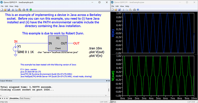

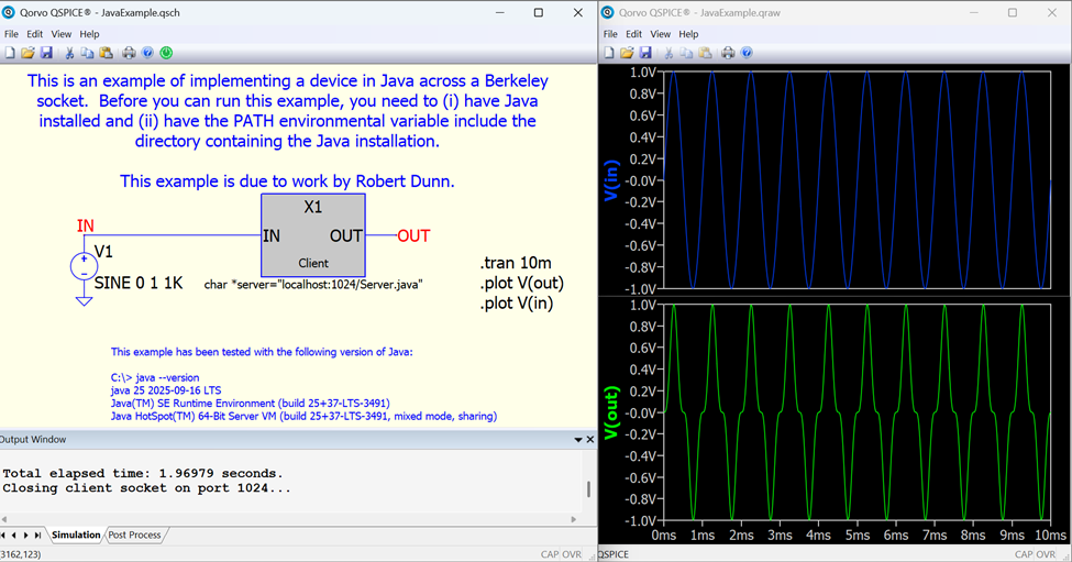

This schematic capture is one by our own Mike Engelhardt, based on work by our friend Robert Dunn. This is an example of implementing a device in Java across a Berkeley
socket. Before you can run this example, you need to (i) have Java installed and (ii) have the PATH environmental variable including the directory containing the Java installation. This schematic capture is in the QSPICE® release under File=>Open Demo…=>JavaExample. Please send any submissions to tim.mccune@qorvo.com. (Schematic Capture Post #080)
