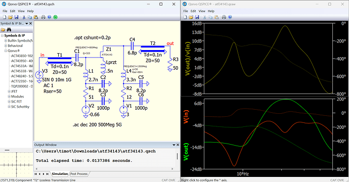

QSPICE Schematic Capture (ATF34143 Transistor Model Test)
For this week’s QSPICE schematic capture, we have “ATF34143 Transistor Model Test” by our friend Alexander Bordodynov. “Testing the transistor model, which I have refined compared to the factory one. I added a gate leakage diode according to the measured value for one transistor.” (Schematic Capture Post #042)
atf34143.qsch (12.8 KB)

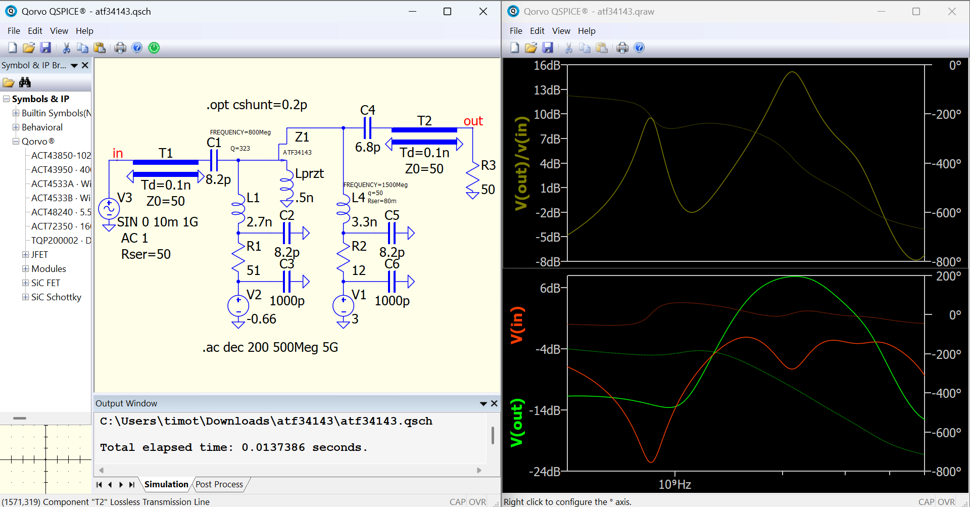

I’ll add a transistor symbol:
ATF34143.qsym (1.2 KB)
