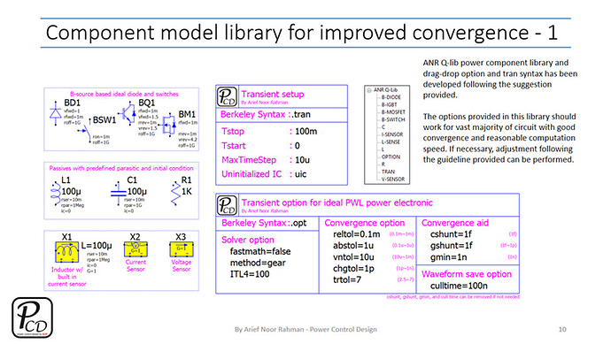

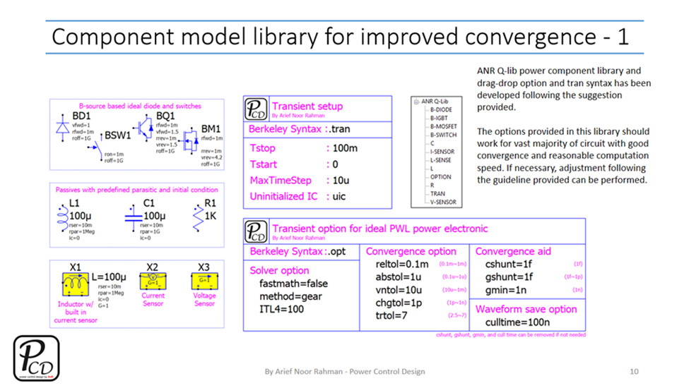

Welcome to a new occasional feature on the QSPICE Forum, QSPICE Modeling Insights. From time to time, we’ll be sharing QSPICE models that you may find useful or interesting. This particular work comes from our friend and frequent QSPICE contributor, Arief Noor Rahman.
“The goal is to ensure robust simulation for my use case and then help other power electronic guys to be able to use QSPICE readily without worrying about the `Timestep too small,’ which used to be very intimidating for me. So this library basically was developed as I needed to figure out ways to get make my simulation to converge with ever growing circuit size (14 MOSFET, 6 diodes, 3 bidirectional switch + 3 transformers, + some complex input power filter).”
You can explore the model here: GitHub - physicboy/QSPICE · GitHub
