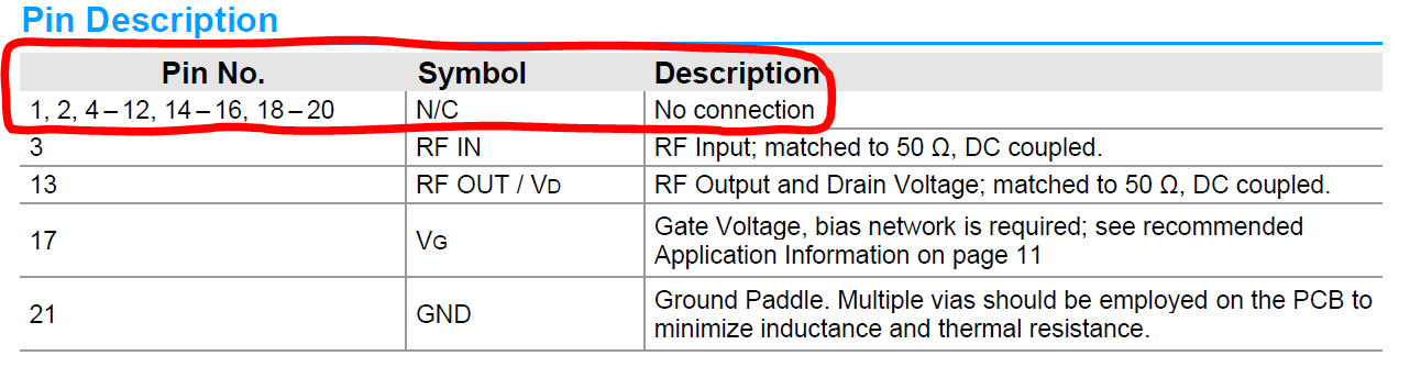

Hello,
Can the no connect pins on the QPA2237 be connect to ground or should they be isolated?
Thank you in advance.

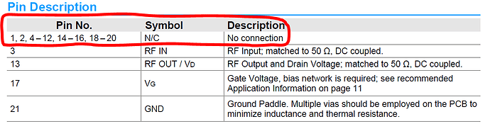

Hello,
The N/C pins can be left open or grounded. These pins are not physically connected inside the package, so either is fine. Often these pins are grounded on the PCB. This can help with top layer ground continuity, thermal dissipation, and mechanical strength.
