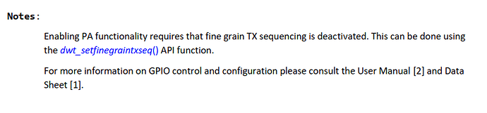

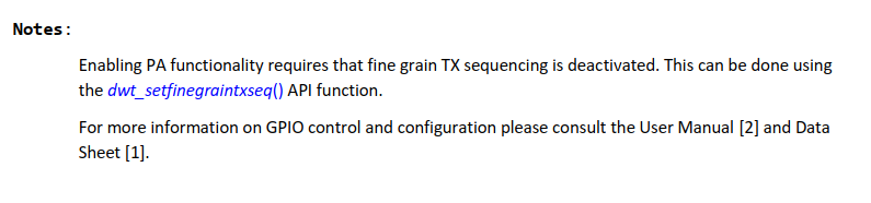

Can you disable fine grain TX sequencing as stated here in the driver API Guide.

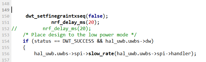

Hi wassim,
Disable the effect is still the same, placed in the initialization,Do you also need to add this code to use PA and LNA normally?

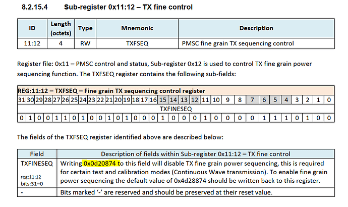

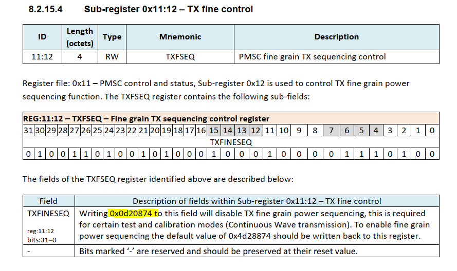

Hi @zhiguo77 ,

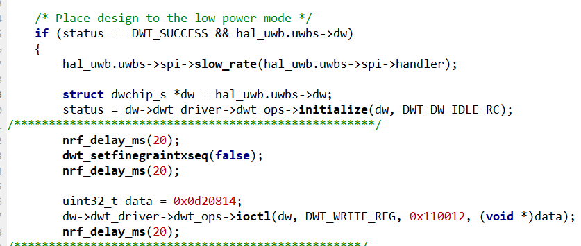

After disabling fine grain TX sequencing, can you change the value highlighted in yellow below and write this value instead 0x0d20814:
You can do as following:
uint32_t data = 0x0d20814
dw->dwt_driver->dwt_ops->ioctl(dw, DWT_WRITE_REG, 0x110012, (void *)data);
Please let me know, if this helps

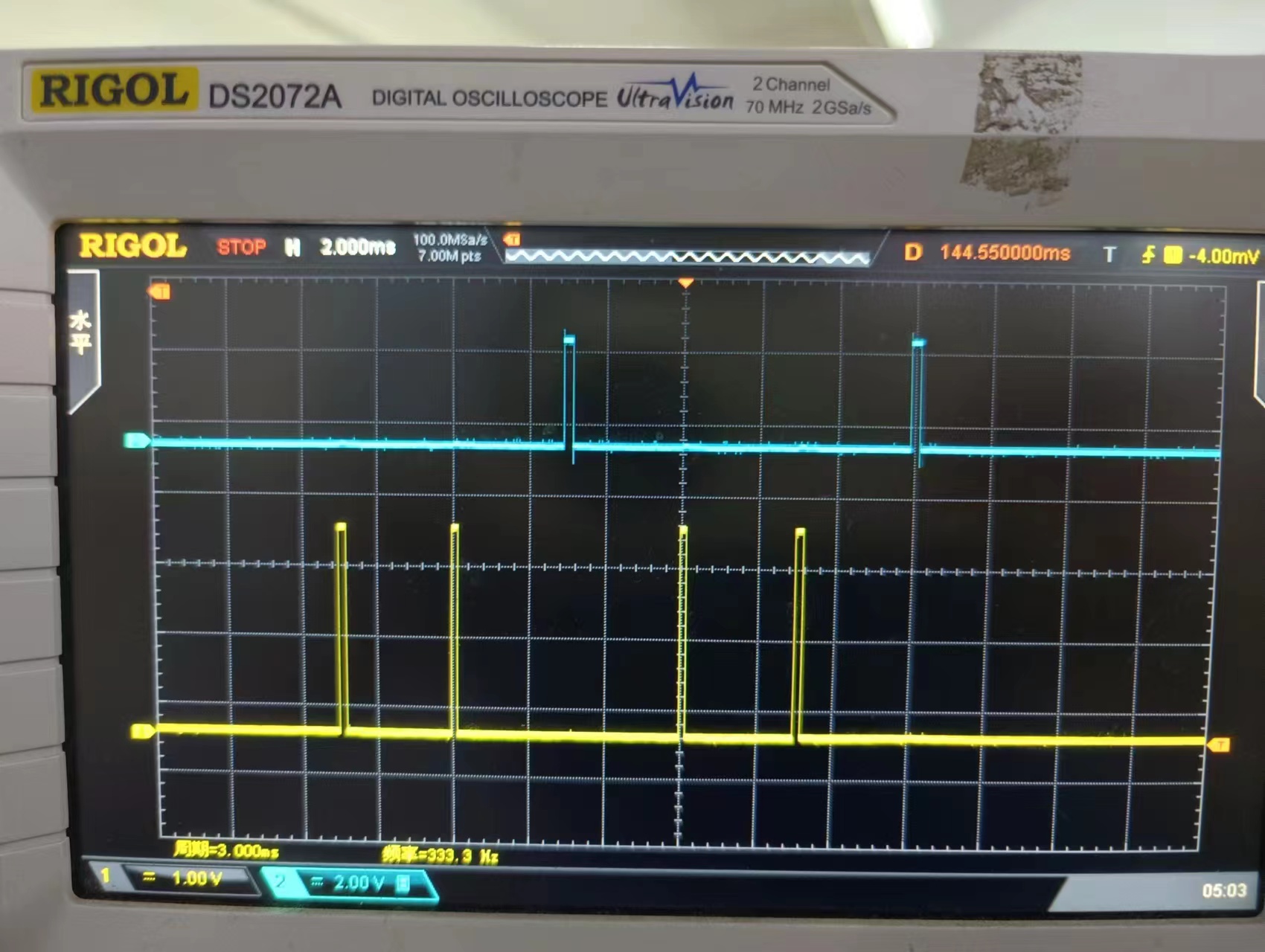

Unfortunately, there’s still a problem. It didn’t work out. Is this a necessary connection for PA hardware?
GPIO4 is EXTPA, GPIO6 is EXTRXE.
But Our hardware is used:GPIO5 is EXTTXE,and GPIO6 is EXTRXE.
For this sdk, is this the reason why it does not work properly?Or what configuration of the sdk does this need to change ?

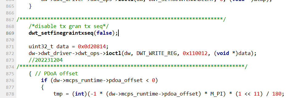

Hi wassim,
Thank you for your strong support and help to answer my questions during this period of time. I have successfully opened PA/LNA, but the code you provided failed to be put in the initialization code of this SDK, so it needs to be put in dw3000_mcps_mcu.c file,and Put in the *static int reset(struct mcps802154_llhw llhw) function ,it is ok

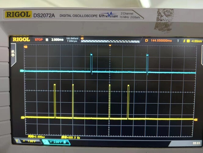

EXTTXE toggling waveform
