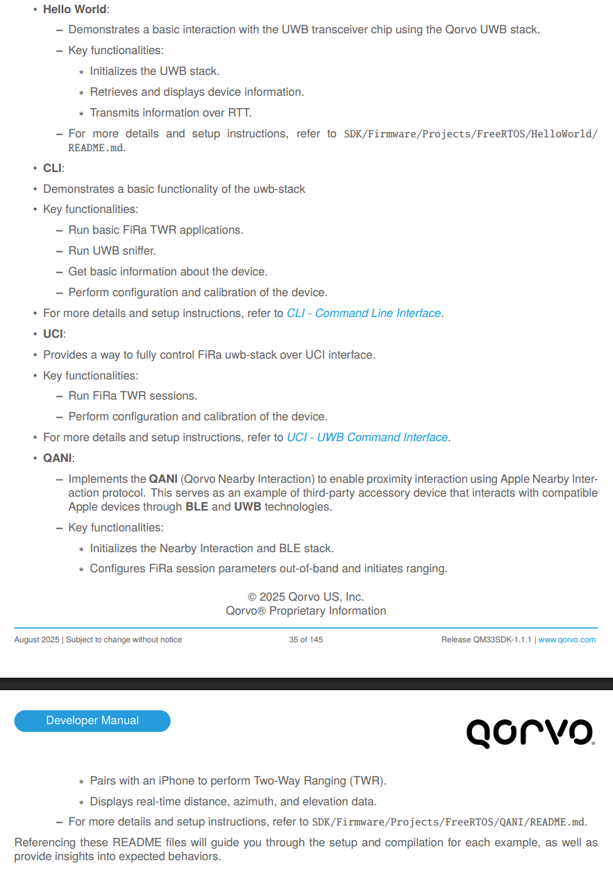

In CLI, VUPPER seems to be fixed at 8 bytes.
If you’re using it on an iPhone, shouldn’t you use QANI instead of the CLI? If you continue to use the CLI, you may need to integrate it.
What is the difference between two app..? what are the steps to integrate it ?
Each project is described below.
For more detailed information about QANI, please refer to the README.
