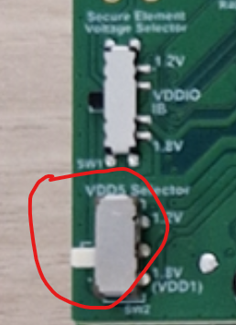

Hi @michele_m31,
May I suggest these steps to test your kit:
  • Please can you ensure that the VDD5 selector on the QM35 is in a valid position (on a voltage) and not in the middle.
  • Install the Raspberry PI image from the public SDK 3.0.0 if not already done QORVO_SDK / Public / DevKits / qm35-sdk · GitLab.
  • Now if you want to run cherry examples from the Raspberry, please ensure to stop the UCI bridge with command below:
    sudo systemctl stop uci-bridge.service
  • and then for example try the command below to test connectivity:
    cherry-device-app
Let me know if that works for you, glad to help.
Thank you
Yassine Bassi
