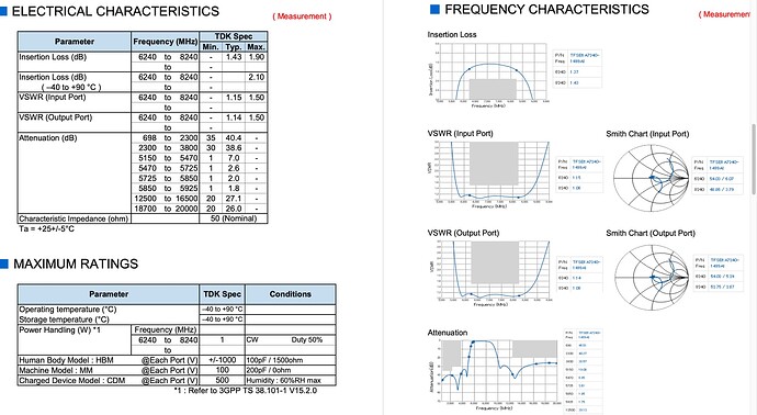

I see that the Murata LFB217G35CFHE826 is shown as an example UWB bandpass filter in the QM33110W datasheet, but this part is too thick for our application. Would the TDK TFSB1A7240-1499A1 be an acceptable substitute? We have a component height restriction of 400um.
New users can’t upload attachments, and also can’t post more than one “media item” so the attached screenshot is about the best I can do to share the RF characteristics of the part at this time. Unfortunately this component does not show up on TDK’s website (or probably more realistically, I’m looking on the wrong TDK website).
