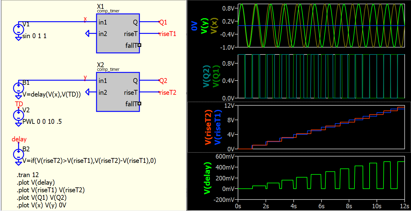

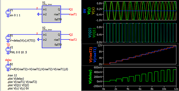

This is not a definitive solution, but I would like to provide an example to demonstrate that achieving what you need may be possible with a DLL (Dynamic Link Library) block. There are many aspects to consider when discussing the measurement of delay between two signals.
In this example, the DLL block can provide the simulation time at which the comparator output changes its state. The delay can be calculated by determining the difference in rise times between the zero crossings of the two signals. However, please note that the calculation result resets to 0 in this setup, as it does not yet handle transitions effectively. Nevertheless, if you have a clear understanding of your specific requirements, it may be possible to write a single DLL to handle your situation. My intention is simply to demonstrate that it is possible to calculate the time difference between two signals in a .tran simulation, although it can be a challenging task.
time_delay_between_signal.qsch (4.9 KB)
comp_timer.cpp (3.1 KB)
