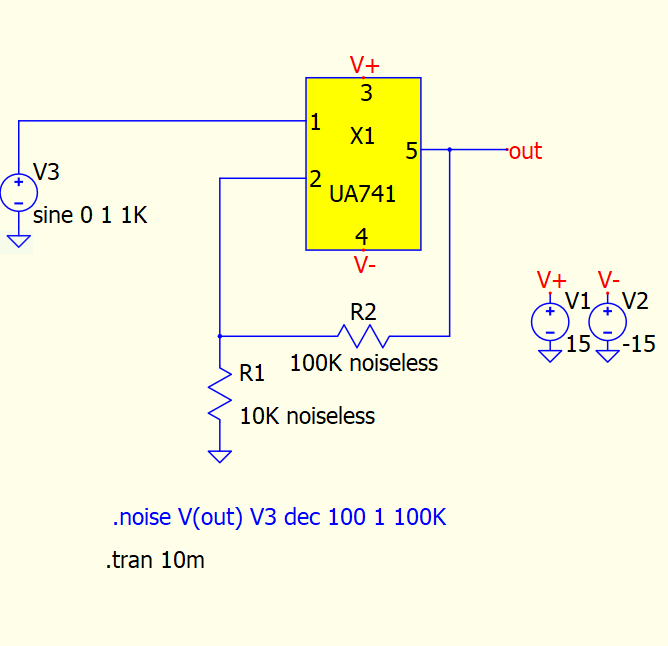

Best way to test noise contribution of opamp is to set resistors to be noiseless.
Best regards
Noisetest.qsch (6.2 KB)
I agree this works for a simple 1-opamp circuit.
My circuit however (I cannot share unfortunately) contains 4 opamp stages, with different gain settings and different bandwidth settings. It would be so great if I could probe the noise contribution from the opamps, just like I can for the resistors…
