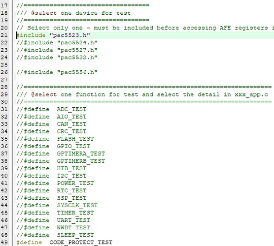

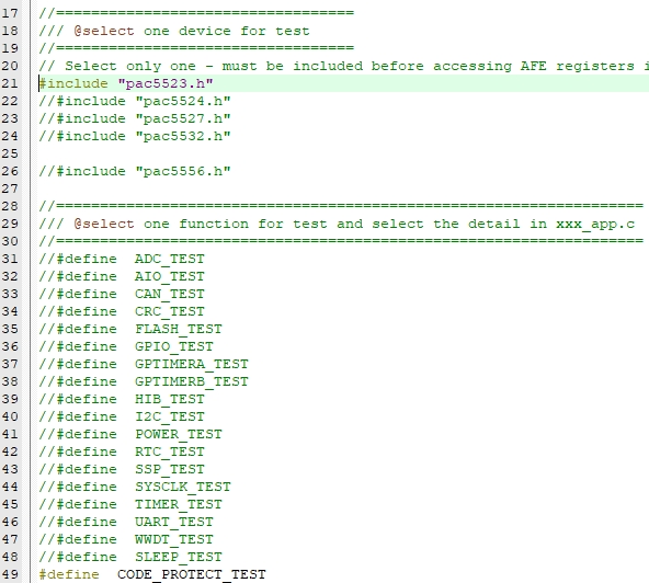

You can first go to config.h and do the configuration as below and then flash it on the board to test.
If you have further question, please let me know. Thanks.
