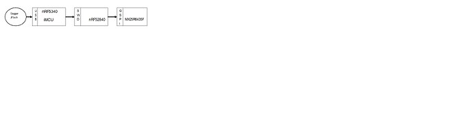

The nRF52840_Developer_Manual_QM33SDK-1.02 in section 4.4.2 provides instructions for flashing nRF52840 firmware (QM33 UCI/CLI HEX file) via the nRF5340 onboard JLink debugger. My understanding of this DFU process is shown in the following diagram.
