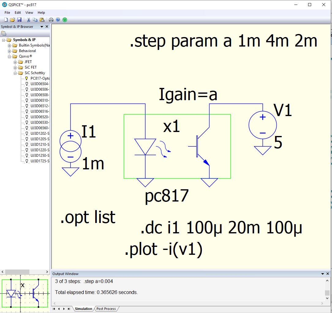

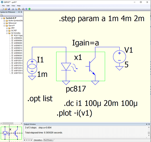

I made an optocoupler symbol and calculated the circuit:

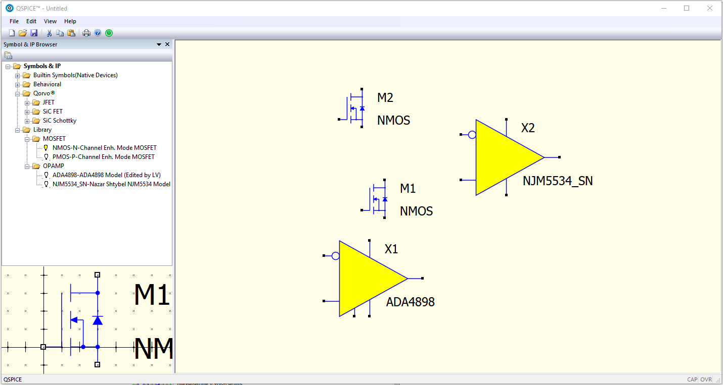

There is no problem to add user folder with symbols.
Thank you very much. It didn’t occur to me that you could make a folder in the system area of the program.

My folder is not under QSPICE installation folder.
This is more secure, because (with some probability) QSPICE may delete user folder(s) after update.

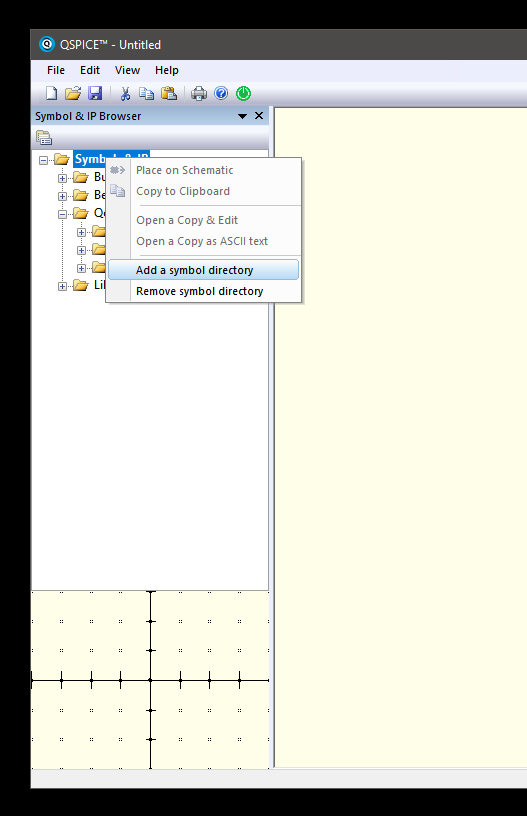

I’m already having problems. I made a folder, but it is not visible from the program. How did you make your folder?
I would like the Author to make a special folder that users could populate and modify and not be affected by the update.
You should create folder with Windows File Explorer, Total Commander, etc.
Then, in QSPICE, click right mouse button on “Symbols & IP” and add folder.
