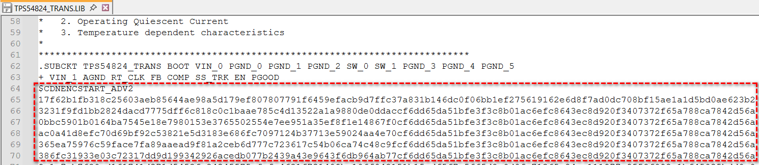

See the [TPS54824 PSpice Average Model (Rev. C)
If you open a subcircuit library and you cannot see a readable netlist, it means it is encrypted for a specific simulator. The TPS54824 library is encrypted for PSpice if you download and open the .lib file.

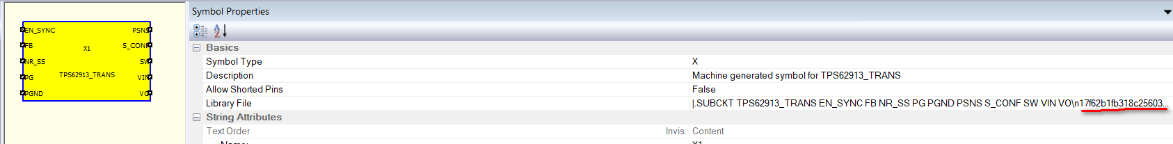

@KSKelvin but if you copy this file into Qspice it generates symbol. Perhaps its very much limited for simulation.

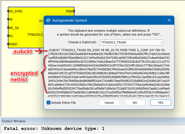

Encryption in SPICE is the encryption of the subcircuit netlist.
For the QSpice autogenerated symbol, as long as it reads the .subckt statement, it can generate a symbol for it. It then directly copies whatever is in this subcircuit into its embedded statement, regardless of whether QSpice can process that or not.
PSpice, LTspice, and QSpice provide encryption, but once encrypted on one platform, it won’t be readable by the others.
@KSKelvin yes, I saw this. Does your explanation means that even if we can generate this part in Qspice it wont work for specific circuit application for encryption?
Yes, no way to work. Encrypted model only work on that encrypted SPICE software.
