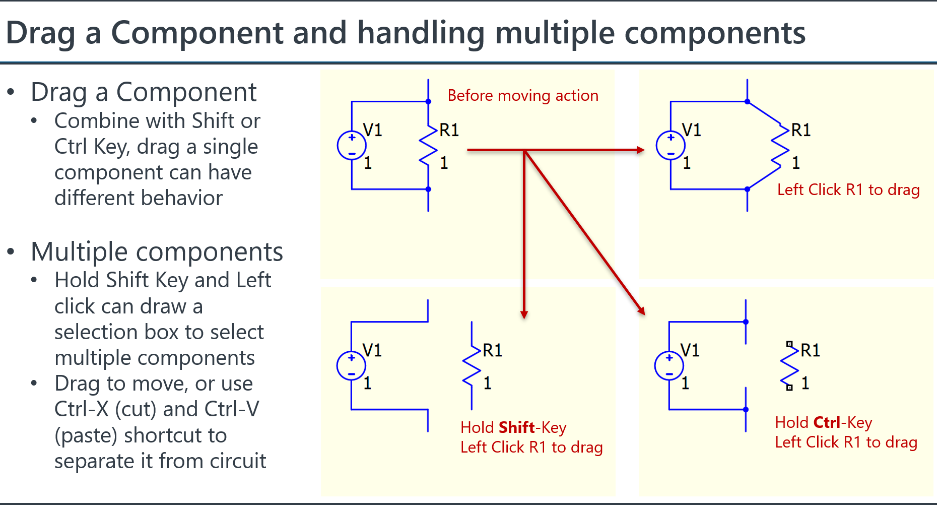

Hello,
How to drag a component in the schematic editor without having it dragging all the wires bound to it ?
I can just drag to have the wire moving them in a free angle way, I can drag + shift to have it with recctangular angle, but I can’t find a wire to drag the component and make an horizontal line from the wire…
See below :
Hi, degleve.
If I understand, try CTRL-X (cut to clipboard) and CTRL-V (paste). Perhaps others will have a better answer.
–robert
I also do that, LTspice24 or latest has a new selection mode that lets you move parts only.
But Qspice has no toolbar, might be a hidden feature somewhere
:thinking: QSpice heavily relies on shortcuts… After becoming familiar with it, you will find that drawing a schematic is much faster. Mike intentionally not to have toolbar in Qspice :joy:.
