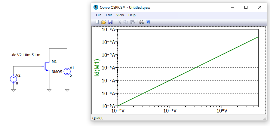

Now I made my 1st QSPICE schematic : 2N7002, source: GND, drain: +5V ,gate : 0..2V ramp.
I expected to see the exponential current rise of I(drain) below VTO, but there is none !?
The default NMOS shows square behavior.. So also not the expected exponential dependence.

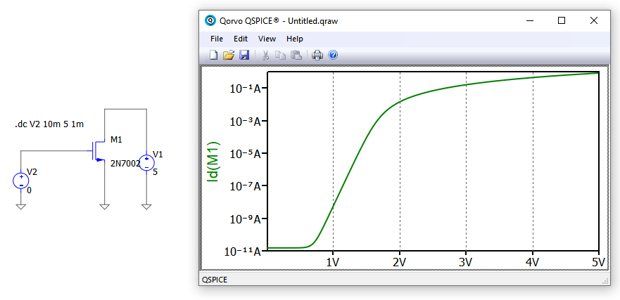

However, the integrated 2N7002 model clearly shows subthreshold region in my sim:
