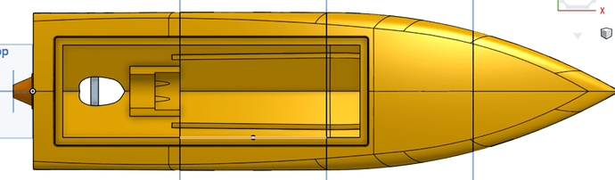

in short,i am building an autonomous boat that needs to get to a preson’s bracelet in case of him drowning. this is not a full startup but an intermidiate level project so were looking to be perfect but to seceed in that mission in out limited time window. ok so this is the 3D model of the boat were looking to print and use: Onshape
it will be approximately 90 cm long and 23 cm wide. so like i said, were planing to send the gps coordinates via LoRa models and because the gps is not that accurate, we want to use the UWB to handle the “final approach”. so we tought to put 3 anchores (DWM3000) and 1 tag (DWM3001c). and im basiclly afraid that the dictance between the 3 anchores (not between the the tag and the anchores) wont be big enough. so a couple of questions: 1: is the solution of using the UWB system possible for our kind of project? and is so, where would you stratigiclly place the 3 anchores? (i know not to put them near the engine, battery, or big wires that would alternate they’re electromagnetic field); this is a screen shot of the top view, if you’de like to mark where woulde you put them,
2: as i said im also using LoRa (868 Mhz) and GPS (L-Band - 1550-1600Mhz), do you thing these will hurt the UWB preformence? i read that these shouldent disturbe each other, but its always good to hear a second opinion. 3: if you think i need to know or consider anything else, please let me know! thank you so much for your help!!!
So you have a tag on a person in the water and want to guide the boat to them.
First issue I can think of is that a braclet on their arm is going to be under the water which means it’s not going to be getting any GPS or UWB signals.
Even if it is above the water it’s not going to be far above it which means your range is going to be terrible. But that’s OK, GPS should get you to within a meter or so.
For the UWB I would have thought to obvious arrangment would be one right on the front so you can get a clear range to target and avoid running into them. And then one on each side, the further out you can get them the better. So right on the edge at the widest point. All mounted high enough to have a good view of the water without the body of the boat blocking the signal for anywhere you expect the person to be.
  1. GPS is receive only so that’s not going to jam anything. LoRa is so far off UWB frequencies that that’s not going to be an issue either.
  2. To be honest if I was asked to design a system along these lines I’d use GPS for approximate location and probably look at a camera based system for the final approach. While UWB would work well for something like this on land I can see the added complexities due to the water blocking signals making it less than ideal at sea. The last thing you want to do is get their arm alongside while hitting their head with the boat.
