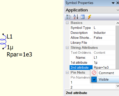

If you are referring to attribute, you can right click on component, show symbol properties, and enable/disable attribute.
