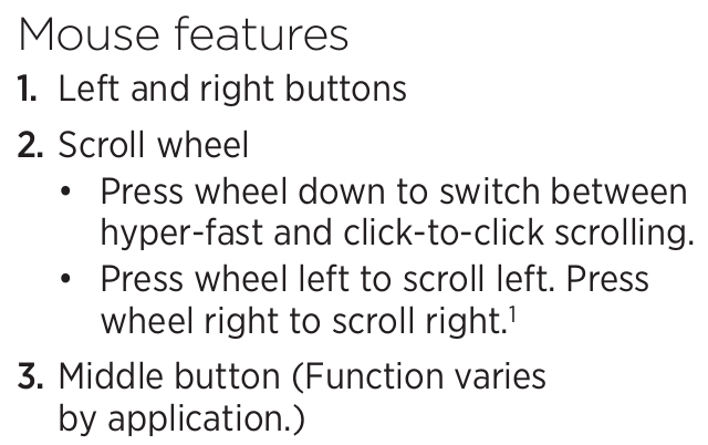

The Logitech MX Anywhere features the MagSpeed scroll wheel, capable of scrolling 1,000 lines per second.
According to the MX Anywhere manual, pressing down on the scroll wheel toggles between hyper-fast and click-to-click modes. OR, Is there anything additional that can be configured for it in Logitech G HUB?
anywhere-mouse-mx-quickstart-guide.pdf

To clarify, I did try testing the mouse wheel both ways—firmly pressing the scroll wheel down as a toggle, and rolling it naturally without pressing it—and unfortunately, it had absolutely no effect.
The G502 uses a completely mechanical lock/unlock button positioned behind the scroll wheel to change modes. The MX Anywhere 2S, however, actually requires you to press directly down on the scroll wheel itself to mechanically shift between the click-to-click (ratchet) and hyper-fast (free-spin) gears.
When the MX Anywhere 2S was in its default click-to-click mode, turning the wheel normally sent zero response to the QSPICE canvas. QSPICE simply ignored the standard scrolling data stream. The only time the software reacted at all was if I held the wheel down while spinning it, which only generated a single, jagged zoom jump because the internal gears were fighting the sensor.
Because a cheap, baseline Walmart mouse worked immediately with zero modifications to Windows or G HUB/Logitech Options, it points to a specific compatibility breakdown between QSPICE’s custom engine and how it processes the high-polling scroll packets generated by Logitech’s advanced MagSpeed/dual-mode tracking firmware.
